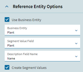

Now, if you choose Extended, you can just use the Chart segment and leave everything else as Dynamic. Do you have multiple sites? Instead of mapping them all, just create a Dynamic Segment, select the Site Business Entity, and now anywhere that Site is in the GL Transaction Type, it will be substituted. This also means that you do not need to create a GL Control Code for every Site, you only need one GL Control Code for every Site since that GL segment will flex based off of where the transaction takes place. You can effectively reduce your GL Control Codes to 1 for everything.

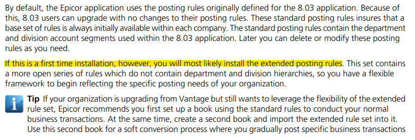

I tried to read up on this to sound like I knew something, but all I found was this single blurb in the Posting Engine Technical Reference Guide.
If that’s the only mention of “extended post” in the entire tech ref on the subject (973 pages in 2023.2!), then where on earth did you learn about this?!

You would have a Dynamic Segment in your COA for Site that you tie to the Plant Business Entity.

The added beauty of it is if you check off the Create Segment Values, if you create a new Site, it should get automatically added to the segment and that is it.

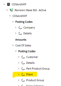

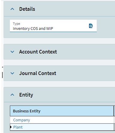

I need to correct something. You define the Business Entities in the GL Control Type (not the GL Transaction Type). But you could just add the Business Entity if it is missing. I just added Plant to the Inventory COS and WIP.

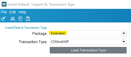

If you want to import all of the GL Transaction Types for Extended, use the classic version. There is a bug in the web version that does not import them. Workaround is to import 1 at a time in web or all at once in classic.
