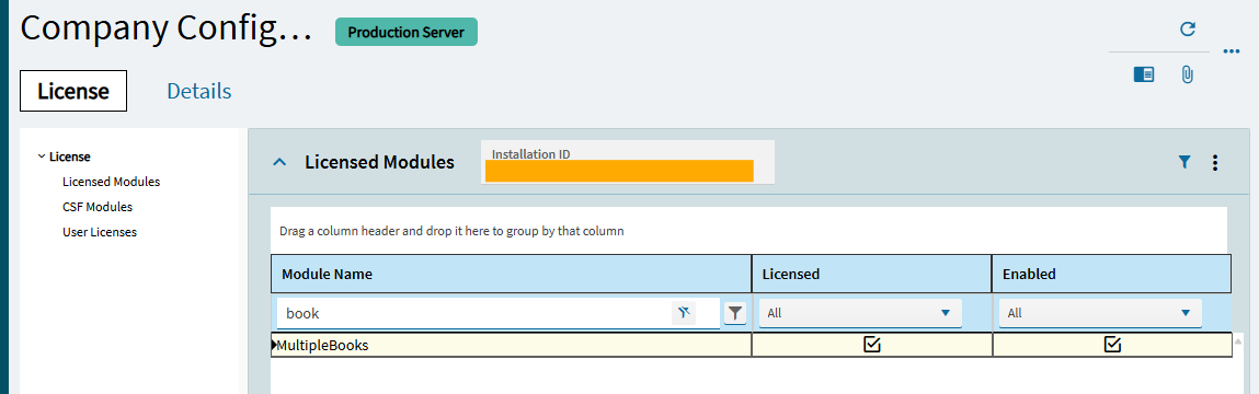

A module for what specifically? The second book? Or the extended rules?
Second Book.
So it is.
Oddly we’ve had it all along, I think. Or maybe added it when we went multi-site.
Ironically we only ever set up one book, though.
Yes, when you went Multi-Site you got the Multi-Book. If you wanted to, you could create a second book that was Extended and run that for a while until Accounting was comfortable with it and then switch Books and stop using the old one.
