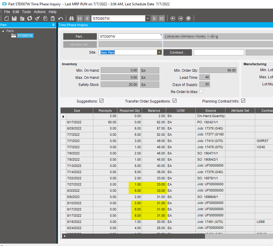

For one part only (that we have found so far), the time Phase Inquiry shows some Balance values that are not decremented when a Job has a Required Qty listed. How can that be?
This is base Time Phase screen with no BPMs on any time Phase method.
We ran Refresh Part Quantities and Allocations, but it did not help, even though the STD007W part number was listed in the report.

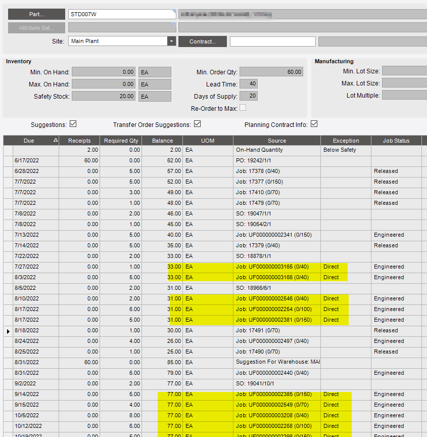

So, looking at more columns in Time Phase, I see that the jobs that did not decrement Balance are listed as Direct.
But, I don’t understand what that means in this context. STD007W is a purchased part and not checked as Buy to Order on either Part or Site tabs. What am I missing?

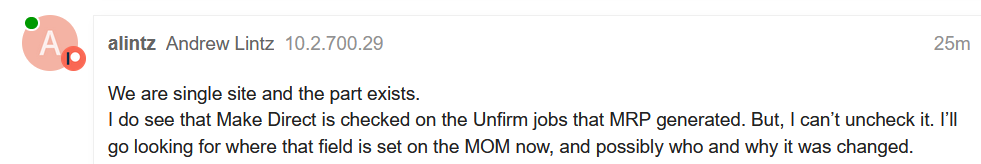

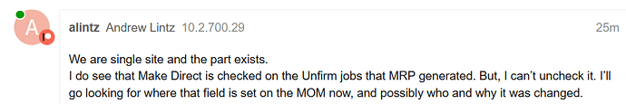

I do see that Make Direct is checked on the Unfirm jobs that MRP generated. But, I can’t uncheck it. I’ll go looking for where that field is set on the MOM now, and possibly who and why it was changed.

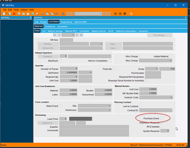

It’s set to purchase direct? Look at the material details in the job.
I don’t think there is a flag in the BOM for purchase direct. Epicor determines what needs to happen by looking at the part setting. Not 100% on this but I’ve checked the ECOMtl table and there is no buy or purchase named field.
That’s correct, but the first step was to make sure we understood what the exception “Direct” was referring to.
Yep, already done ;p
Make direct and Purchase direct are two different things.
@Banderson Yes, Part STD007W is marked Purchase Direct on the Material List for the unfirm jobs that show up with the Direct exception in Time Phase. But, the Purchase Direct checkbox is grayed out so I can not change it.
