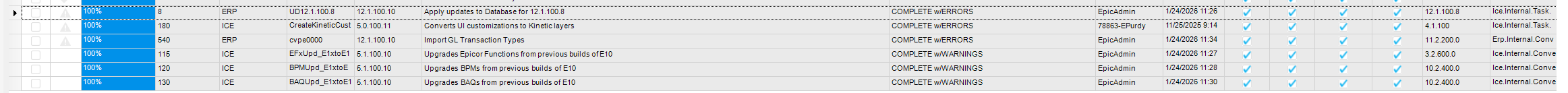

Hmm.. I wonder if one of these is the issue..
