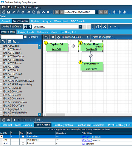

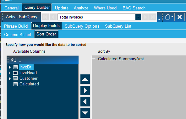

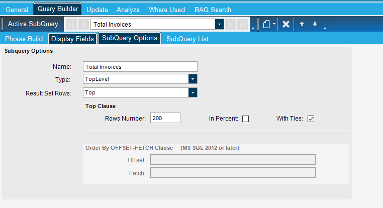

I got it to work by making a BAQ with a subquery no TOP clauses needed at all. I built it off of Invoice tables as itâs more accurate with actual billed orders but same concept if you want to use Orders.

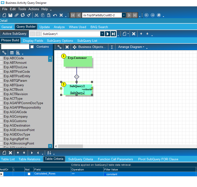

If you reference the SQL query that @Matthew_Lawless posted, it has a calculated field that counts the rows per custnum by the sum of Invoice totals:
ROW_NUMBER() OVER (PARTITION BY customer.Name ORDER BY sum(invcdtl.DocExtPrice) DESC)
Which I put in the subquery then used Criteria to limit the main query to <= 5 per the first screen shot.
This isnât perfect, if a customer orders the same part over time this BAQ will not total all those invoices for that part. It may need a another subquery to sum up all invoices (orders) by partnumbers.
Wouldnât just a sum(invoice amount) give you the sum for each part?
You could try that.

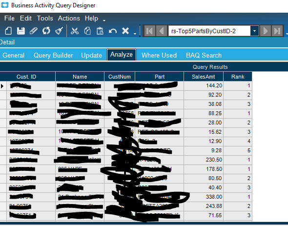

It looks like it works. Thanks for all the help!
