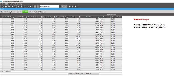

Hi Experts,
I am trying to create a BAQ that will display total price sold on specific product group.
In a standard BAQ format, it shows all occurrences of a product group thereby creating hundreds of lines.
Is there anyway I get the total price by product group to show on the BAQ without doing sum?
Please see attached for reference.
Chemuel
Try to use Group by and Calculate field with Sum Aggregate function.
Hello, I tried this and it works fine with standard fields. Thank you.
On this specific case, I would like to get the sum of the calculated fields but they aren’t stored in any table I assume.
you could calculate the value for each line and sum that…
Sum (OrderRel.OurQty * OrderDtl.UnitPrice) for example…
Just use Sum(CalculatedFieldName) and replace that with whatever your field name is.
Dragos
Thanks Gentlemen for the replies.
Working as intended now.
