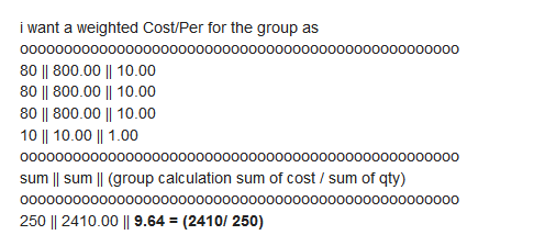

so instead of averaging the Cost/Per’s
i want a weighted Cost/Per for the group as
oooooooooooooooooooooooooooooooooooooooooooooooooo
80 || 800.00 || 10.00
10 || 10.00 || 1.00
sum || sum || (group calculation sum of cost / sum of qty)
250 || 2410.00 || 9.64 = (2410/ 250)
but i can’t seem to get this in a simple BAQ
(pardon the multiple edits to correct my math - i was a math major at one point - not sure what happened :slight_smile:
