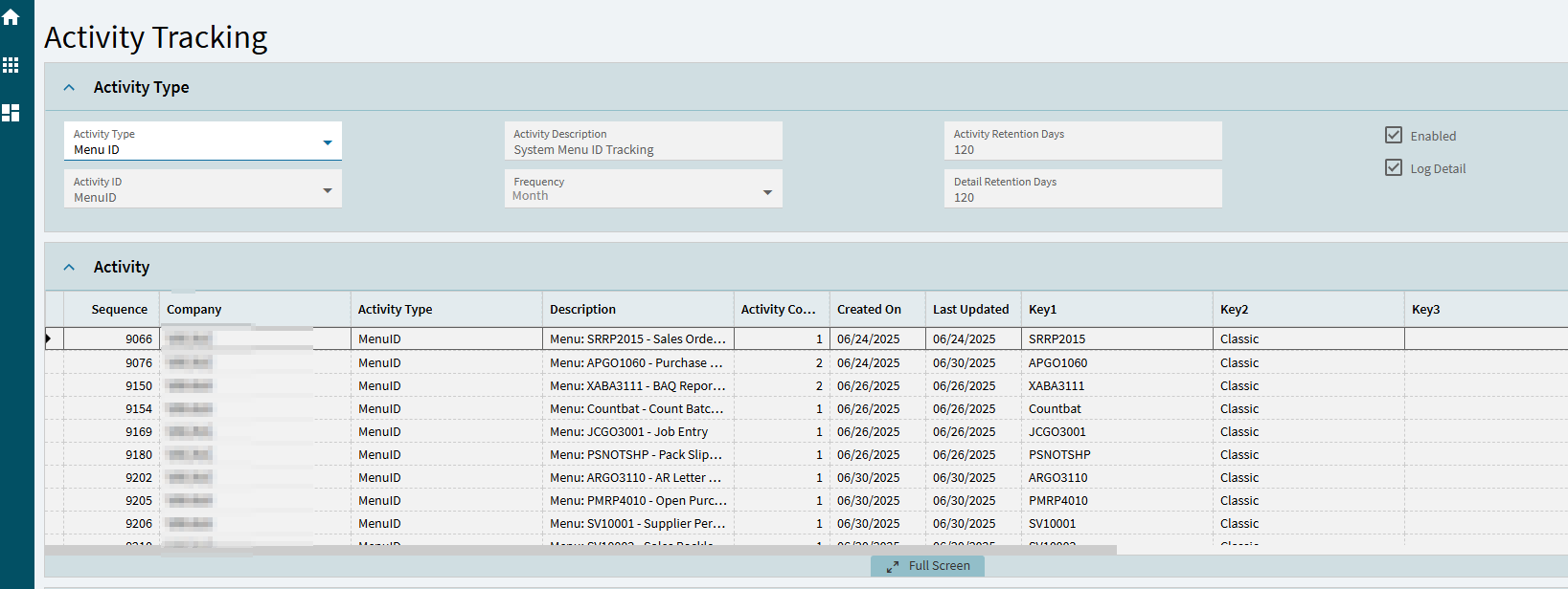

Why not use activity tracking?
It’s a handy tool, just don’t set your dates to too wide a range. I have also noticed if you enable then disable. The data collected the first time you enabled does not seem to get purged. Had 10 gigs worth of logs that we had to clean out.

Alisa,
To start with, didn’t know it was there! I’ll have to check it out!
It doesn’t look like dashboard is an option, so might have to play with and see if BAQ catches it (then circle back to the dashboard from there). Otherwise, looks like I could track by Menu ID.
Thanks!
Dashboards are captured under menu id type activity.
@aosemwengie1 has the right idea here. Enable the activity types and set logging for a few months. I wrote a baq to summarize this by user, would really like to summarize by role or user security group.
