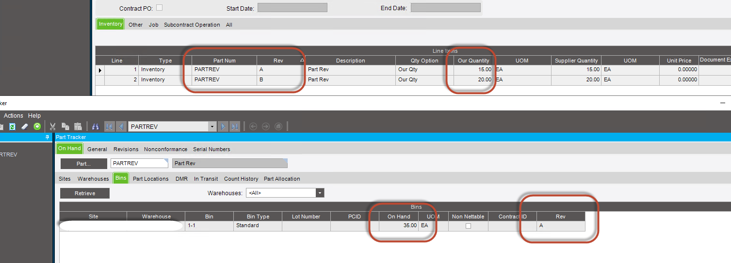

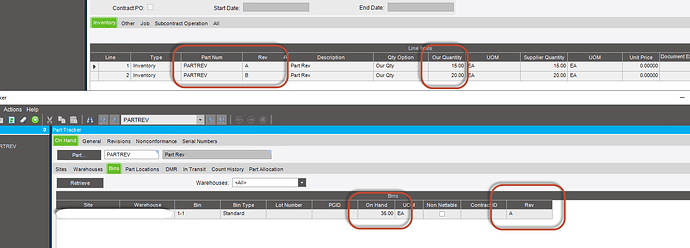

Did a test on 2023.2.6. Created a new part, flagged part as Track Rev in Part UOM Conv.
Created a PO with 2 different revs. received to the same bin. it combined them and listed as one rev.
expected behavior is to see both revs in the location.
@timshuwy is there a different tool i should be using to view inventory by rev?
I used part tracker.

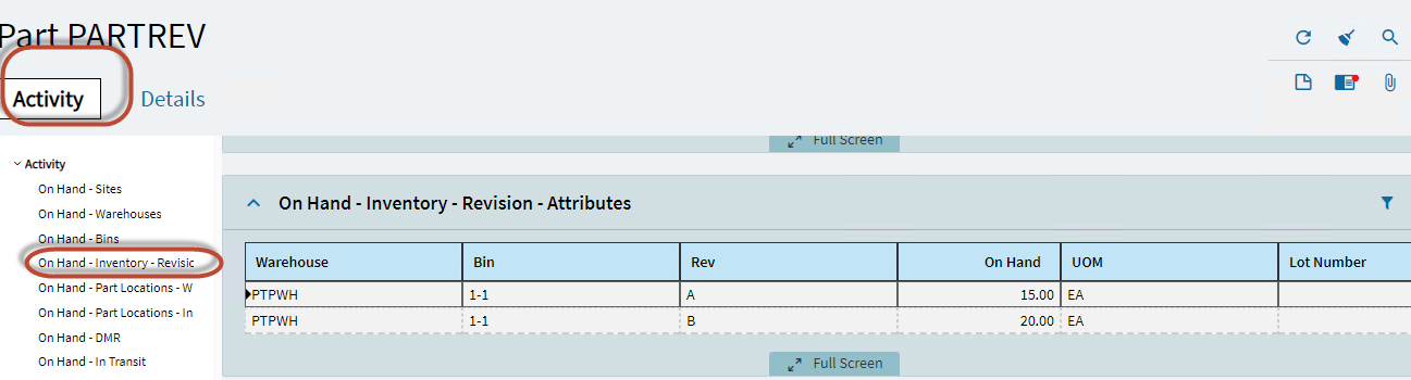

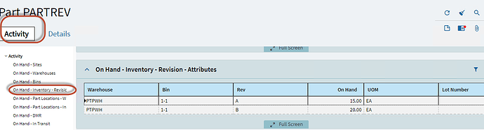

Follow up:
I was told by Support that you can only see Revs by using the kinetic part tracker form and clicking Activity. After making that here is what I see.
Next test is when doing inventory moved or issues to job will it ask for the rev so it decrements the correct rev quantity.
Yup. The “Track Inventory by Revision” functionality is a more recent addition, and was not added to the Classic screens. They’ve been threatening that for some time now, and this is the first one I’ve actually seen.
Although you could PROBABLY customize the Classic screens to add the checkboxes and stuff, it would equally probably be a nightmare.

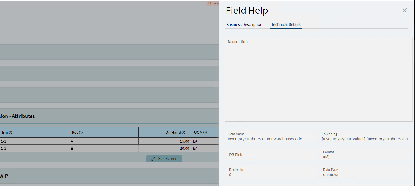

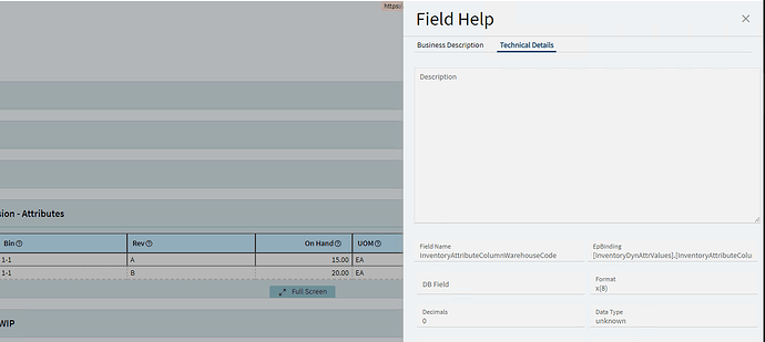

Does Field help exist in kinetic? Im trying to see how epicor is storing that rev on hand data.
Yes… open the screen you want and click on the Help icon, click the Help and Support Center button, then check the Display Field Help check box. Each field on the form will sport a question mark that when clicked will show the field help.
Thank you.

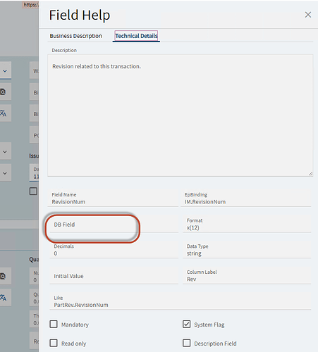

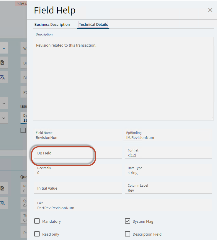

No Db value for the on hand quantity or Rev.

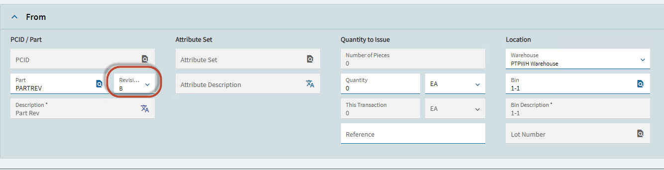

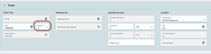

So issue material is asking for the Part Rev. I was able to issue the wrong rev to the job though. No Db field on the Issue material Rev so not sure how to do a check so we dont issue the wrong rev to the job.
