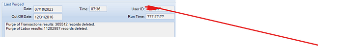

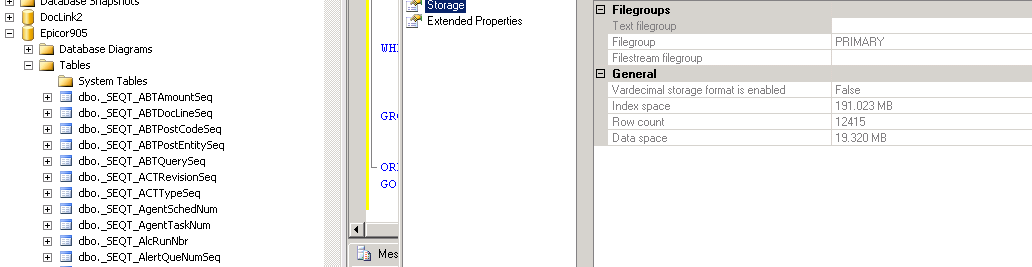

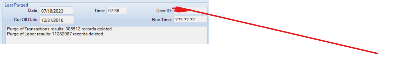

We’re getting ready to transition to Kinetic and I ran a DB purge and summarize to clear out some old data in an effort to reduce the database size (365 GB) prior to the conversion. In doing so, apparently the purge and summarize process must have deleted the entire TranGLC Table, YIKES! As you can imagine we’re in a bit of a pickle. Fortunately, I did grab a daily backup prior to running the purge task… unfortunately, it’s been 2 days since I ran the process. I’ve ran it before for other tables, and never had this problem. I did not select the Journal Details table when running the process. Picture of the results below along with a pic of the SQL table from our production environment showing only 12k rows…

Purge and summarize is supposed to delete some tranglc records that meet the purge requirements what did you use for a cut off?
I used 12/31/2016 as the cut off and it deleted 10 million rows. Been trying to reimport data into the table, but it fails quickly on duplicate value. Definitely in a major predicament right now. If you’re able/interested to help as a consultant DM me and I’d greatly appreciate it

I do appreciate the advice. We’re on 905.702A. Definitely was not expecting this when I clicked the “Labor” checkbox. I’d run it before on other tables but never that one…

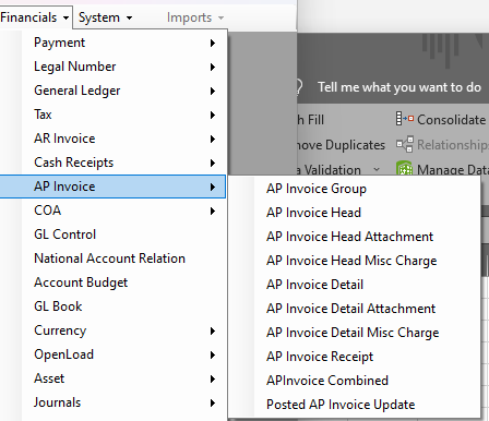

I do have a DMT question I’ve never noticed before. There’s not DMT option for APInvJob charges, anyone aware of somewhere that may be hidden?
Once we’re through this mess i’ll post some notes about the process should anyone have to go through this again, hopefully they’ll have a little bit of a guide.
I don’t think there’s a DMT for that one, you might be able to replicate it fairly easily via REST (or via an EPicor function) but that’s gonna require some custom coding or tooling usage.

That’s what i was thinking…I don’t see myself doing anything in E9 for this, but i’lll probably write something in application studio for our conversion to kinetic.
