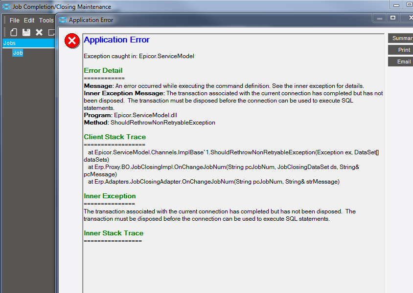

Hi Team
We got this error on a job last week when we went to close it (Job Closing). Tried restarting task agent and then the whole server (as part of scheduled restart which was going to occur anyway). Thought this might clear it out but alas no. Has anyone seen this before or could shed some light on the causes/resolutions.

Check the job tracker for the job you are trying to close
Do you have any labor transactions entered but not approved or any non
conformance’s related to one of the operations still sitting in inspection?

Can you post the full server stack trace - probably from the servers Windows Event Log?
Epicor Server Flight Data Recorder
We were told by EPICARE it was going to be fixed in .2 update.
