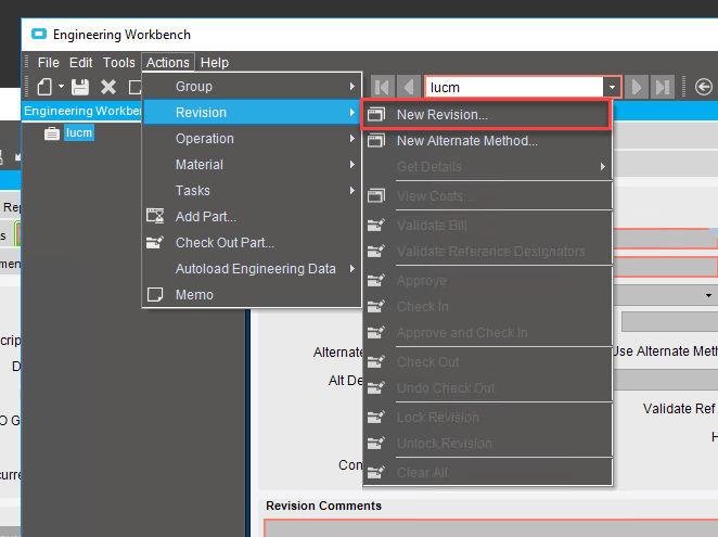

In EWB, I have this:
When I call this “New Revision” menu point, it does go through the motion of creating the PartRev.

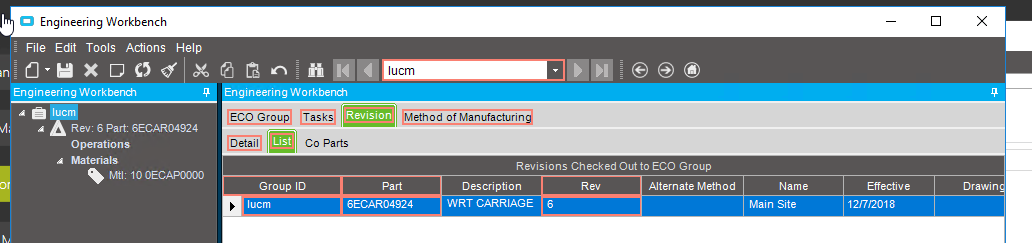

Then I also have this:
It may be where I’m misunderstanding what Epicor’s EWB does. In my mind, undoing a checkout should throw away the changes I made to the part while it was checked out.
Unfortunately, the PartRev still remains after Undo Checkout. So it seems the two actions are really not meant to be “atomic”.

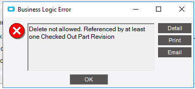

I tested the scenario (server is back online), but I’m getting the following error in the Epicor UI:
In the EWB, I created an ECOGroup. I then created a Part Revision, as we discussed earlier, by going to the Action > Revision > New Revision menu point.
This asked me to select a Part, and assign a Revision number, as expected. Just for testing purposes, I then added a Material to my Part Revision.
Now, as suggested, I try to directly delete the ECOGroup, but I get the above error message. I may be missing a step?

I went through the steps again, and right now this is what I have in the Revisions tab:
This Revsion “6” is the one I just created, but that Part has another Revision “0” visible in the Part Maintenance.
Now I can’t simply delete the “lucm” group. Should I “Undo Checkout” on Revision 6 first? Seems to me this “saves” the Revision and it becomes visible in Part Maintenance.
