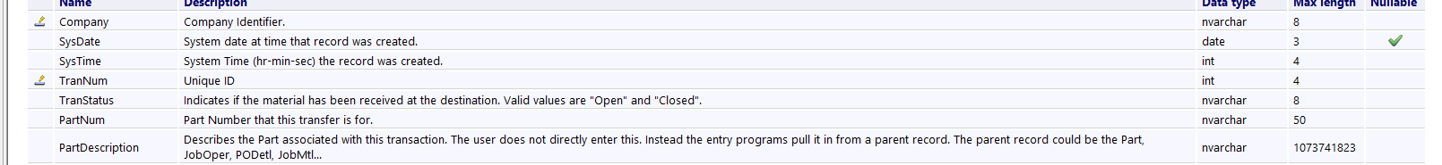

There is a table called Erp.PlantTran.
I don’t know if it is due to bugs or our own process or not, but there are sometimes discrepancies between PLantTran and the results I get doing what you were originally doing with TFOrdDtl and TFOrdHead or TFShiphead and TFShipDtl
And yeah, plant tran has a transtatus field that says open or closed.
Good stuff. Thanks for pointing this out. It might actually answer a different question that I had bouncing around in my head. I was seeing an extra transaction in SNTran that was not lining up with one in PartTran. It was related to when we transferred a serial tracked part from plant to plant. It was like this weird transaction that was “closing” the transfer order but didn’t show up on PartTran. I wonder if this is where it was coming from.
