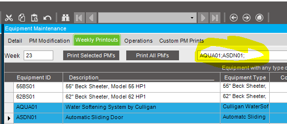

Has anyone had issues with TrimEnd not working. I have the following code and no matter what I try it isn’t trimming the last semicolon.
private void PMEquipString()
string strBuilder = "";
equipIDs = string.Empty;
foreach (UltraGridRow row in gridPMSWeekly.Selected.Rows)
strBuilder += row.Cells["Equip_EquipID"].Text.ToString() + ";";
equipIDs = strBuilder.ToString();
tbSelectedWeeklyPrint.Text = equipIDs.ToString();
tbSelectedWeeklyPrint.Text.TrimEnd(';');
MessageBox.Show(tbSelectedWeeklyPrint.Text);
