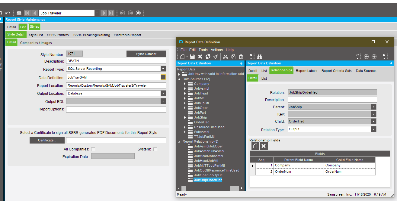

The end goal is to add the bill to customer name to the shipping schedule in the job traveler. I’ve added OrderHed as a data source, and given it a relationship to JobShip:

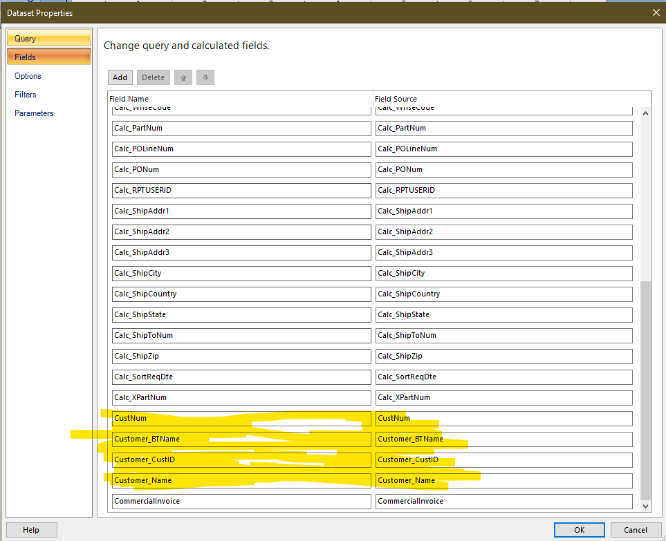

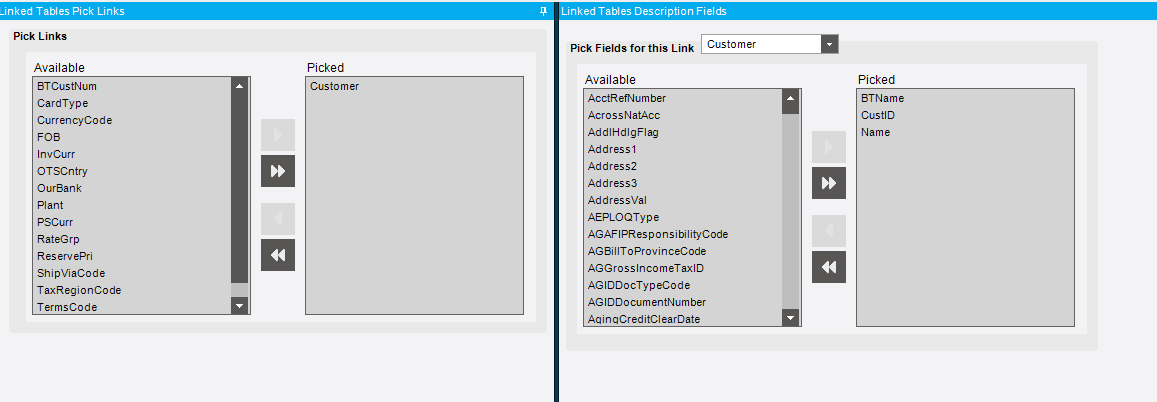

Then I also chose the Customer in linked tables and added their name:

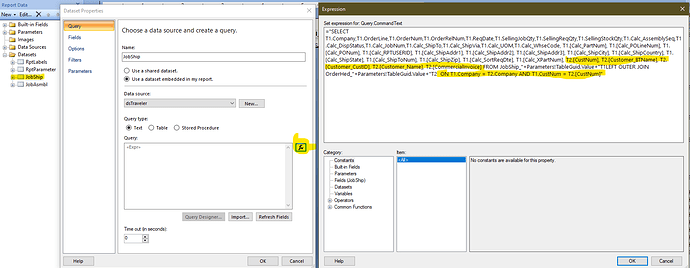

Finally, I went into the report builder and added the table and fields to the query:

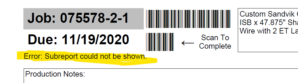

When I test the report, it runs with no errors, but the sub report does not render:

Just a wild guess, is there a space between T1 and LEFT in the expression?
PS: I think you would want to maintain spacing near the quotes too as you are building the SQL statement and the T1 or T2 need to be the alias to the tablename_guid - not tablename_guidT1. If that makes sense.

I think you spotted it. Because there should also be a space before the T1 as well. And you are missing a space between the second table"+Parameters!TableGuid.Value+" and T2
Okay, my query is now this:
="SELECT T1.Company,T1.OrderLine,T1.OrderNum,T1.OrderRelNum,T1.ReqDate,T1.SellingJobQty,T1.SellingReqQty,T1.SellingStockQty,T1.Calc_AssemblySeq,T1.Calc_DispStatus,T1.Calc_JobNum,T1.Calc_ShipTo,T1.Calc_ShipVia,T1.Calc_UOM,T1.Calc_WhseCode
, T1.[Calc_PartNum], T1.[Calc_POLineNum], T1.[Calc_PONum], T1.[Calc_RPTUSERID], T1.[Calc_ShipAddr1], T1.[Calc_ShipAddr2], T1.[Calc_ShipAddr3], T1.[Calc_ShipCity], T1.[Calc_ShipCountry], T1.[Calc_ShipState], T1.[Calc_ShipToNum], T1.[Calc_ShipZip], T1.[Calc_SortReqDte], T1.[Calc_XPartNum], T2.[CustNum], T2.[Customer_BTName], T2.[Customer_CustID], T2.[Customer_Name]
, T2.[CommercialInvoice]
 FROM JobShip_" + Parameters!TableGuid.Value + " T1
LEFT OUTER JOIN OrderHed_" + Parameters!TableGuid.Value + " T2
  ON T1.Company = T2.Company AND T1.CustNum = T2.[CustNum]"

Just noticed this.
In your RDD you link from JobShip to OrderHed by Company = Company & OrderNum = OrderNum. When in your SSRS report you link with Company = Company & CustNum = CustNum

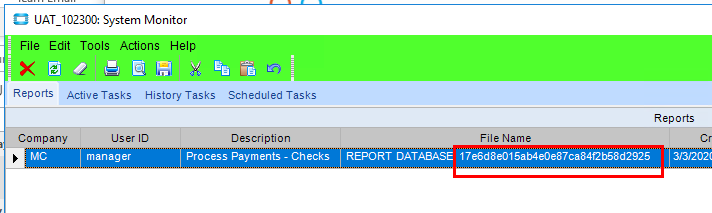

The GUID created for the main report (which can be found in the SysMonitor), will be the same for the subreports. So open the Sub report in Report Builder, run it and enter the parameters.
You’re not adding the Customer table to the RDD. And BTName is not a native field in OrderHed. So the actual fieldname in the temp dataset will probably be something like Calc_BTName, or OrderHed_BTName

Thats why I named it Customer_BTName – I saw elsewhere on these forums that was the right way, that you do T#.LinkedTable_Field
Is that not right?

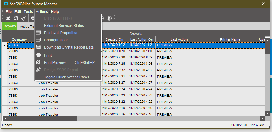

Look for column named File Name. If it’s not visible, you may have to personalize the SysMon form to show it.
The GUID is what’s in the box.
Also, set the archive period for at least a day, so that temp table isn’t purged while you’re using it for debugging.
The GUID is over on the right end of all the columns. column heading File Name

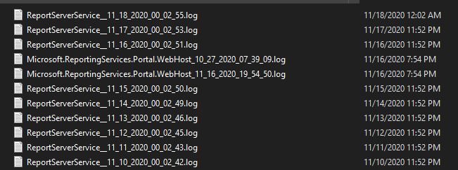

Does SaaS MT give you access to the SSRS Server Logs folder? It has all the info you seek :slight_smile:
:laughing:
@ckrusen Where do I put this in the report builder?
@hkeric.wci No, but if I begged Epicor they might look at it for me and give me the error message…
