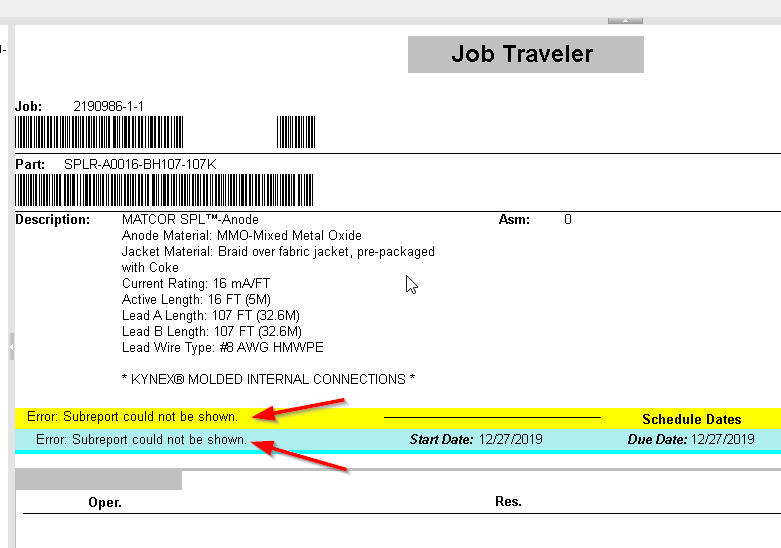

@Evan_Purdy - Do you see the “Error: Subreport could not be shown” when the report is uploaded and run from the normal printing method?
If you’re trying to preview it from a downloaded report, running in Report Builder on your workstation, the sub-reports might not be accessible.

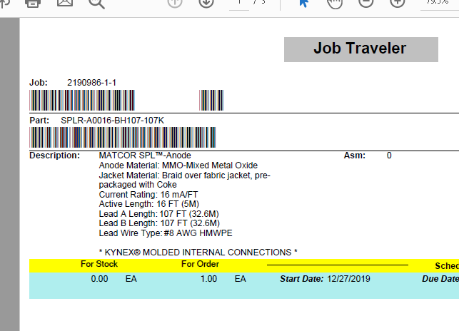

But after uploading and running it from Job Entry, I get:
NO ERRORS!!!

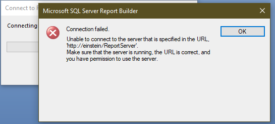

When you go to preview the report in report builder you will be prompted with a parameter asking for the GUID. This is where you can supply the value you found in the System Monitor for when you ran your report in Epicor.
Ah, yeah, that would require being able to see the report server.

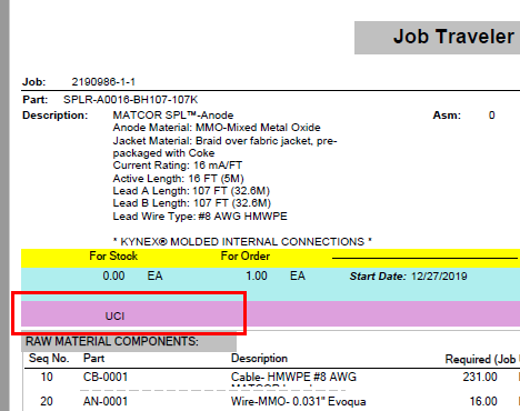

I’m going to try and do what your end goal is. And to make sure I have that right, you want the name from the BTCustomer selected on the order, the job is for. For example,
You want what the arrow points to, to appear on the Job Travler in the Ship Details area.

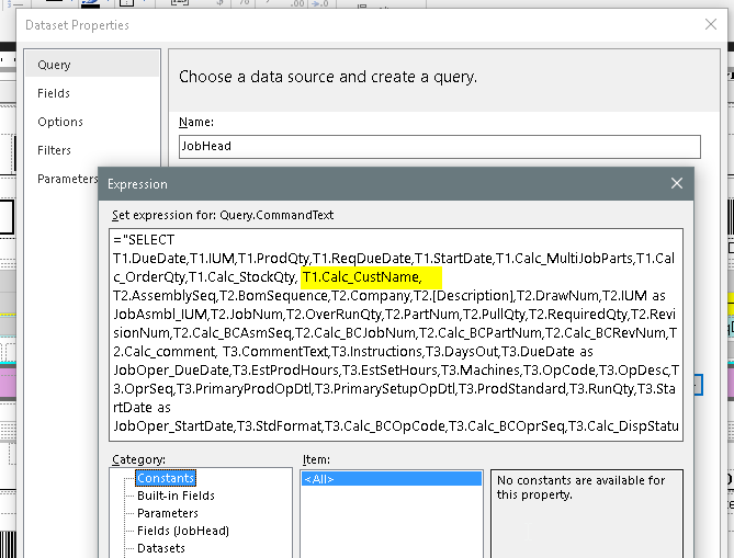

The Customer’s name is already in the RDD. No need for a new one. But it’s not in the Query expression. So just add it to the JobHead Dataset Query
And the query field for it:
Then you can insert it into your report.
and get:
