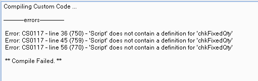

I am trying to disable a custom control on the JobMtl screen when the FixedQty checkbox is cleared.
Below is my script and the error I am getting. I am sure it is something simple. Any advise would help

I would highly recommend you use a RowRule for this.
The chkFixed quantity field can’t be accessed directly, however the dataview will. Just use a row rule.
Jose -
Thanks for getting back to me.
Yeah … I switch to the RowRule … I had forgotten about that.
Works perfectly!!
