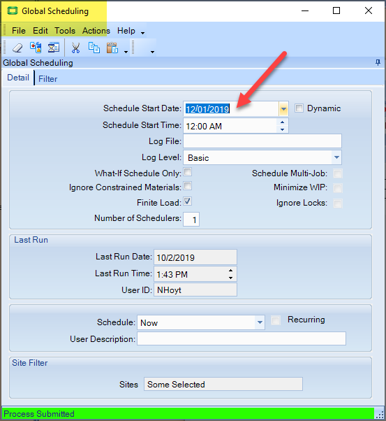

Hi Mike,
In E10 I see that at time of Global Scheduling here, I can change the Scheduled Start date to what I want. Then the jobs on the Adjust Global Scheduling order list that haven’t been deleted and are unchecked for backwards schedule will get forward scheduled. Can you do this in E9 too? Would that help?

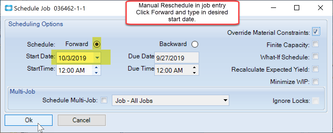

This is akin to manual scheduling in job entry clicking Forward and inputting start date:

After all is said and done, if you wish to set a start date then you will need to forward schedule the job with the start date. Material lead times will be used from that date. Later on if you wish you can always reschedule the job without
affecting any completed operations. If you wish (after engineering), you can always reschedule the job backwards or use the global rescheduling.
Reminder: If you decide to global reschedule the shop but don’t want a specific job to move, make sure to lock the job.

Charlie this may be my best option. Thanks
