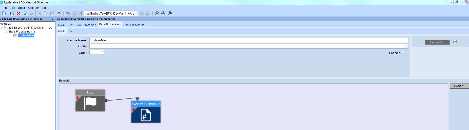

You can always customize the UBAQ.Update method. That way you can only update the fields you want.
Interesting…that’s a really good idea
Does the Update method get re-written by Epicor though? I assume you’re talking about the pre-processing but I think the base remains
I am talking about updating the base processing of the UBAQ. I am only suggesting this on UBAQ. This might not work for what you want it to do. This will allow you to update individual fields at least. I am sure there are other techniques to use.

Which is why we had to change the base processing behavior for most of our Updatable Dashboards.
this is something a customer should not have to do. ESPECIALLY, when just about every class on BPM’s they tell you to not mess with the Base unless you really know what you are doing.

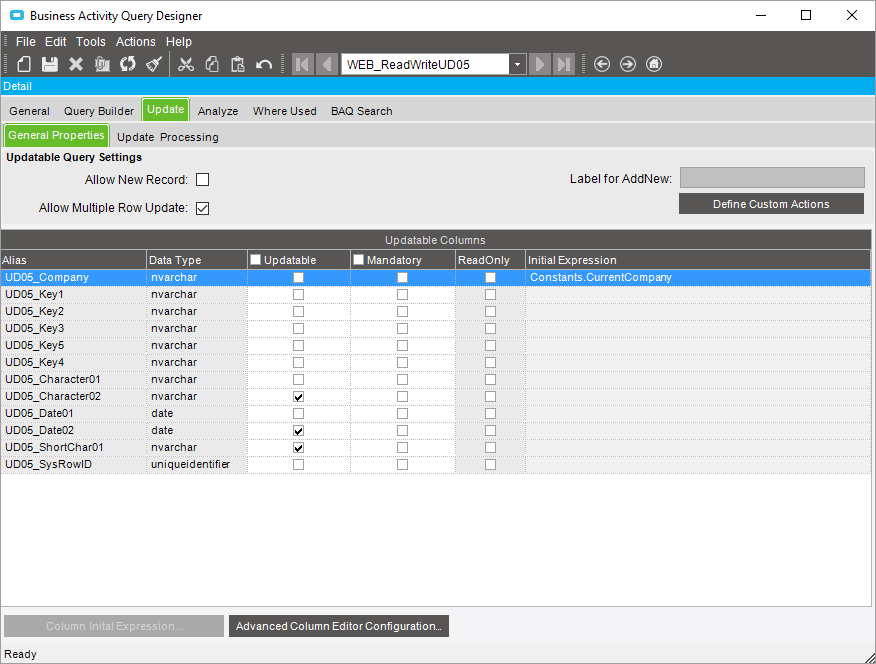

As I wrote in your original post, you don’t need to set all fields, you only need to set fields included in mapping on Update tab in the BAQ designer, go there and remove the fields you don’t want to send. As I remember only key fields are mandatory, all other can be removed
