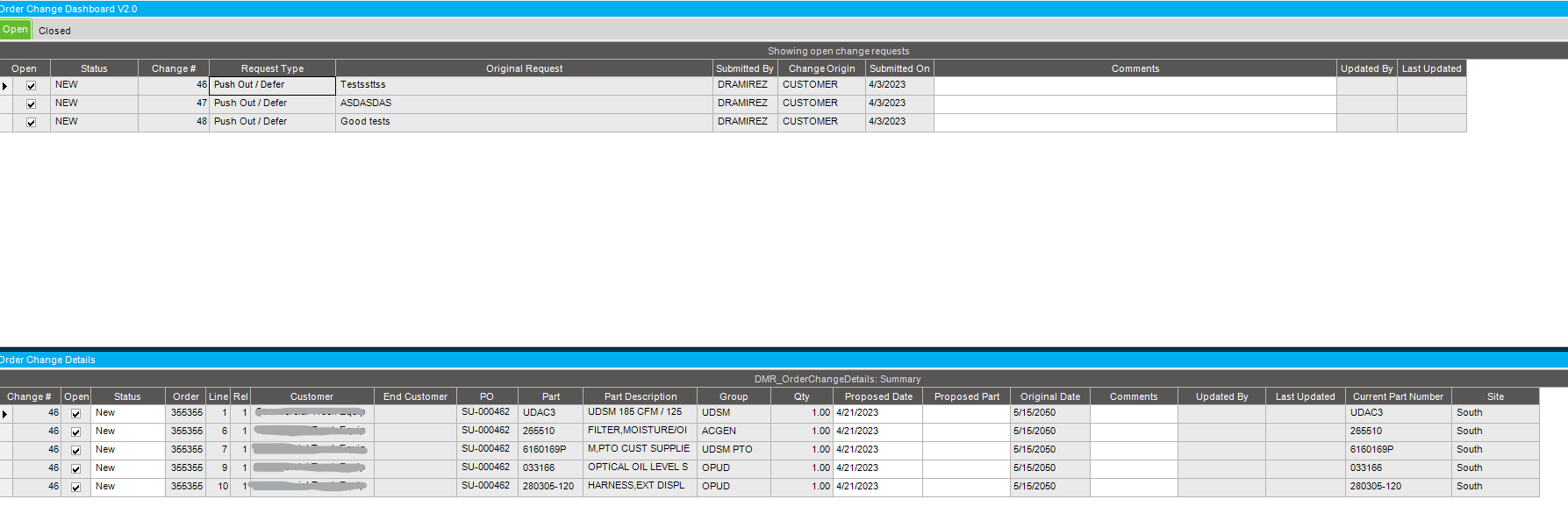

So the idea of this dashboard is supposed to grab all releases on an order to allow a user to select which ones they want to put in a change request for. You select the first column either by clicking each line or by pressing the Select All button. If you have a mass update, you can put the details in on the left and click Copy To Selected. It fills in all the rows with a check box in them with those details. Or you can manually fill in each line if they are different.
Once you click Submit and Close, it should create records in UD100A for each line selected. I am always missing the first line… See?

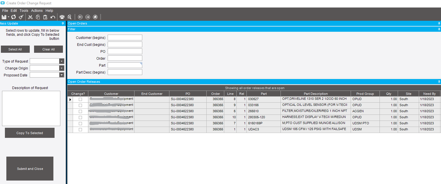

Here is the customization that I have on the Order Request dashboard.

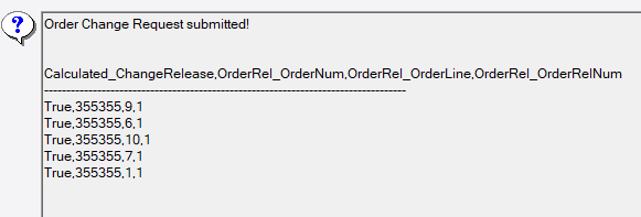

Go change your update code to pop up an infomessage for rows count with rowmod U.
(in baq bpm)
5 rows instead of 6.
Simply by me clicking off the first row (default row) onto a different row is enough that all my rows go into the Update.
I’m not seeing anything in your code that raises red flags. May be some kind of bug.
Comment out the code everywhere where you are selecting/deselecting rows.
Leave that poor grid alone and let’s see where it goes.
