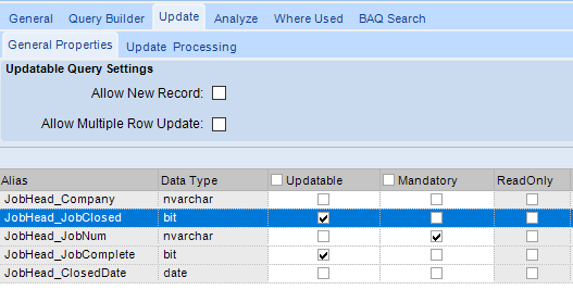

Create a UBAQ with the JobHead table. Include Fields JobHead_JobComplete and JobHead_JobClosed in Display fields.
Then, inside the Update Tab, check both fields as updatable:
Then, in the Update Processing tab, select Job Entry BO with UpdateExt method.
That’s it. Save BAQ and Create dashboard…

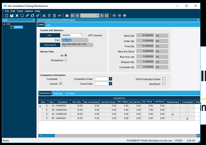

Thanks for your response. I tried it, but I have some problems. I don’t think it triggered all the background processes that should clear open material demand / clear time phase/ clear scheduled load, etc.

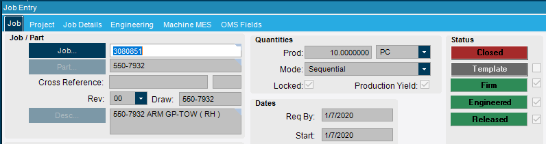

For example, I completed & closed Job 3080851 thru the UBAQ, and the Dates are not populated in the Job Closing screen.
The Job shows Closed in Job Entry though,
But the component demand is still open and displayed on Time phase
From what I read thru different posts, we need to replicate the BO’s called in the Job Closing screen.
