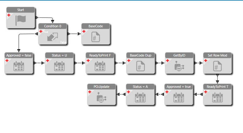

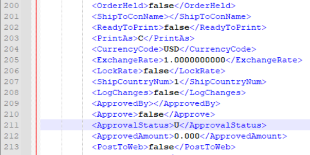

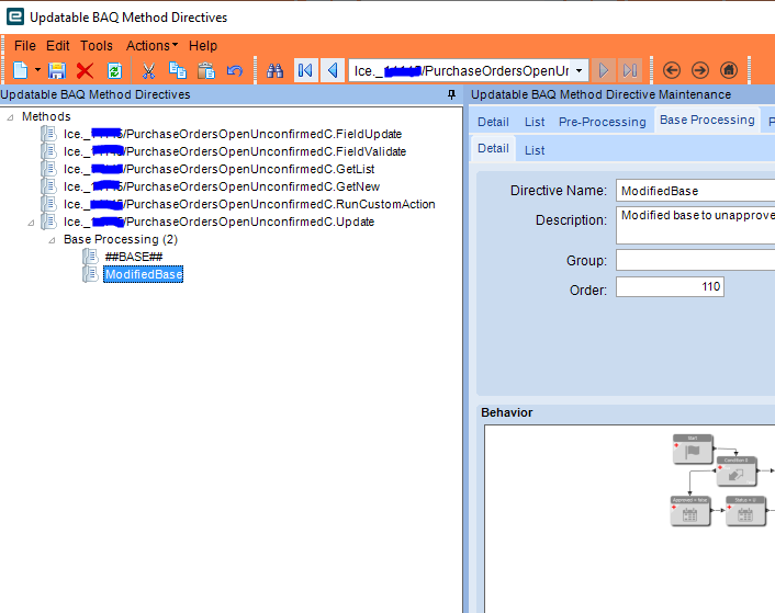

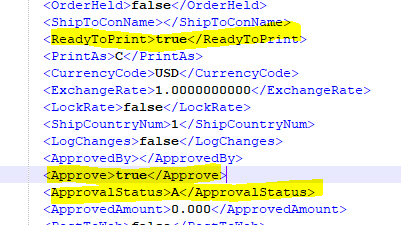

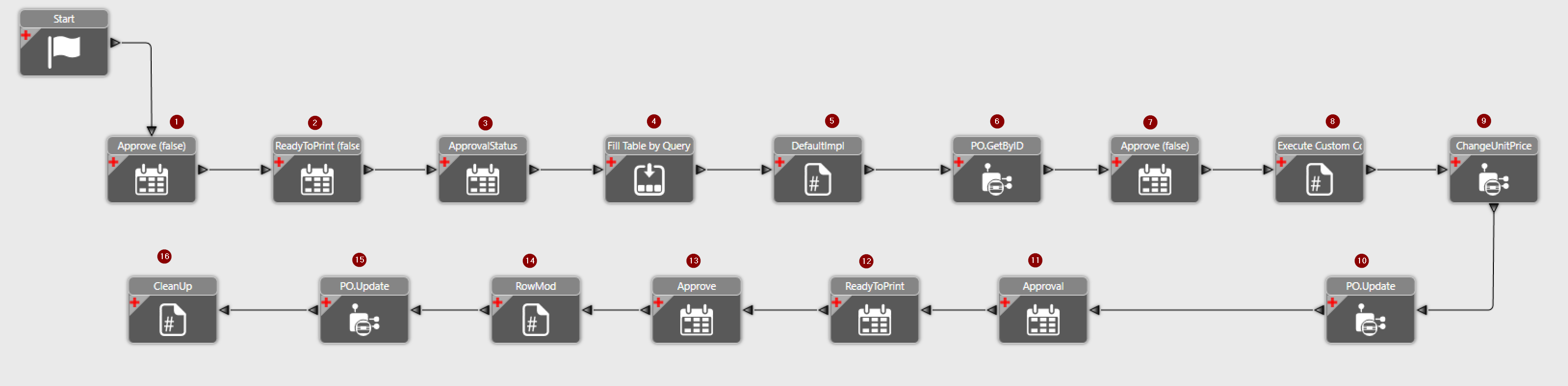

I used the same order on the Set Field Widgets as documented in the linked posts and then I changed the order too, still with no success. I looked at a trace of manually unapproving (the exact PO I am trying to change on the uBAQ - so I have permissions to change this PO) and reapproving and so I adjusted the widget order to the order shown in the trace (I am not very good a reading traces):
But it still gives me the same error (PO is not approved and cannot be flagged as Ready to Print). I even bypassed the Set Field widget to make Ready to Print TRUE and I still get this error. The links to other threads were for 10.2.400 but we are on K2021.2.7. Can anyone point me in the right direct as to why I am getting this error?
In the trace, do you see Epicor just setting the Approved Flag to “U” or is it calling a method to unapprove and THAT sets the Status flag to unapproved?

This leads me to believe that the DefaultCode has an issue (because my initial condition checks to see if the PO is approved and if not, it goes to the default code):

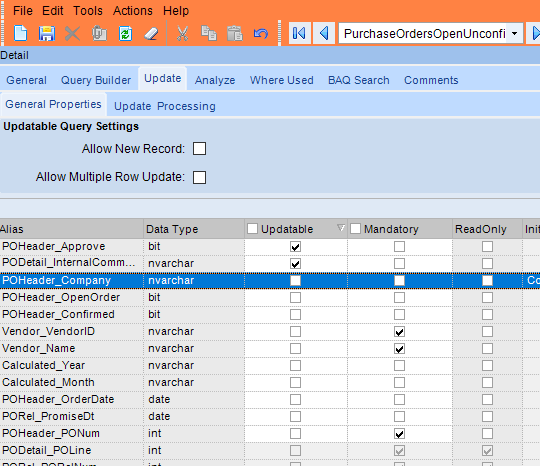

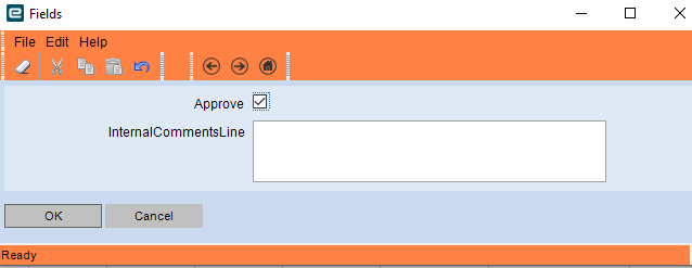

So if I make the POHeader Comments field updateable, and in the uBAQ change the Comments and hit update (in the Updatable Query block), I get the following message "Query returned 1 row(s). Updatable query action fulfilled and reported no error.:

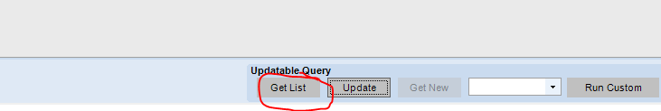

Then when I go to Get List in the Updatable Query Block:
This is just how I code. I do one thing and make sure it works. If it does, then I move to the next thing. Write the code to unapprove the PO and test the out of it. When testing, I will log in a second time (even sometime with a different user ID) and check to see that another user sees the PO unapproved and not just me in my development environment.
Another issue is on a uBAQ, in Analyze, after you update, you need to Get List to see the actual current status (that tripped me up for a while).

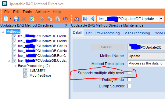

So my uBAQ will update multiple dirty rows (even though Supports multiple dirty rows is grey and unchecked), but I get a business logic error: "The table queryResultDataset.Results has more than 1 record.
The updates are occuring, but the uBAQ fails to re-approve the POs (for multiple dirty rows only). I made the POHeader_Approve field updatable and I can change the Approve status for a PO one at a time.
