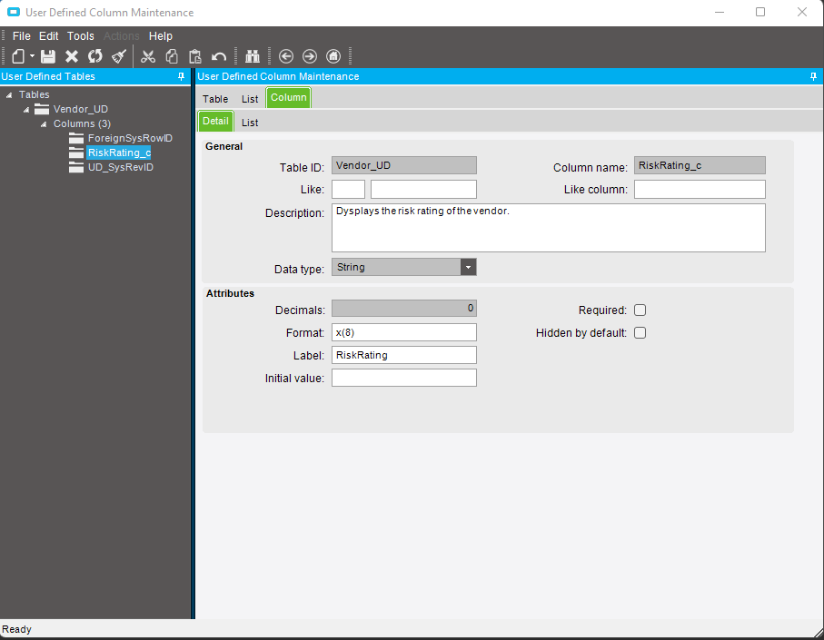

So here is my plan (which I am just beginning now). Create a new UD _Vendor table. Create the column I want to add. In this case I believe I want a column of data type string with 8 char. Then I run regenerate data model. Next I add the User Defined codes I want this drop down to have and add them to the user defined field through Extended Properties? Lastly I make the customization on the dashboard and place is where I want it? I’ve never done this before. Kind of following the help menu here.

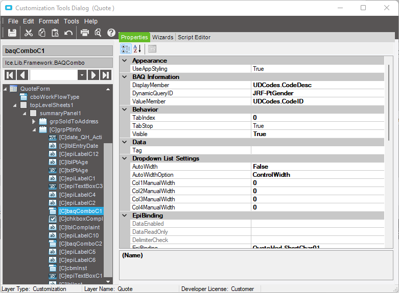

I’m gonna show you a BAQ combo since they are super easy.

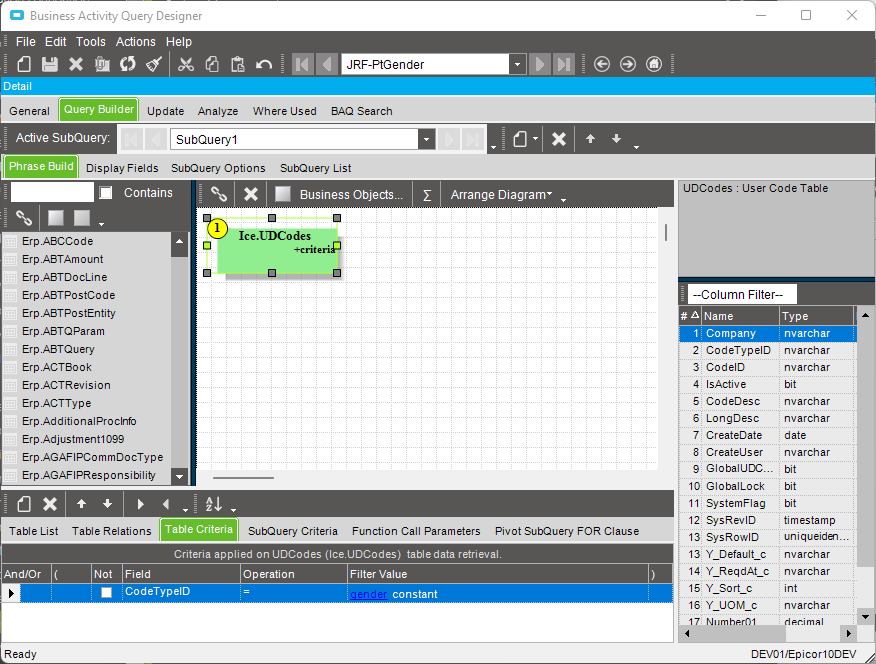

Create your static list in the User Codes.

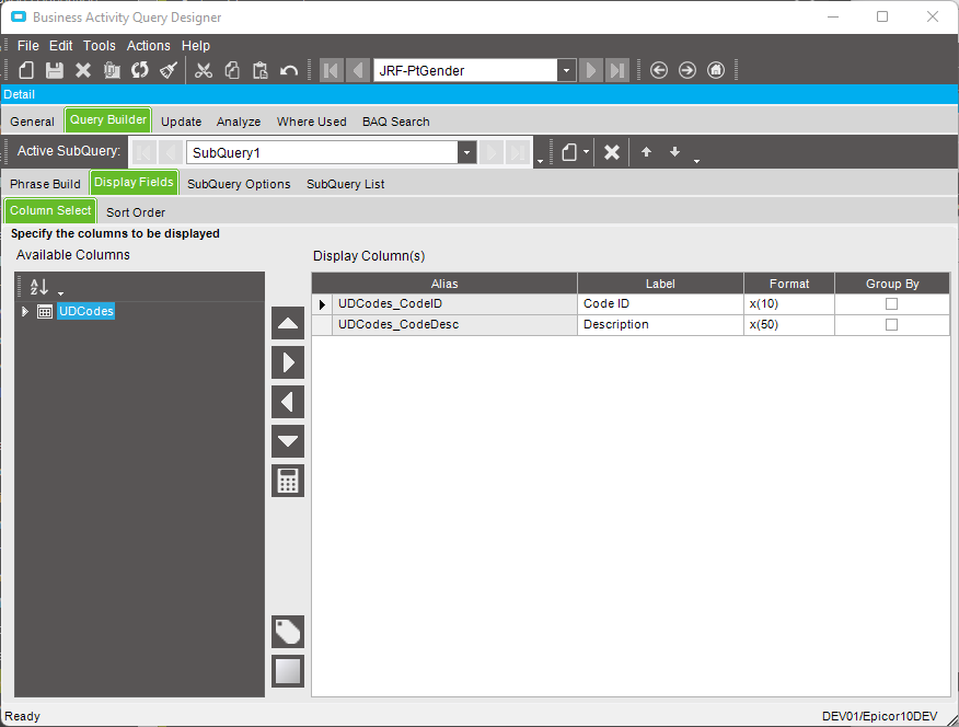

Create a BAQ that reads that list and displays the columns you want.

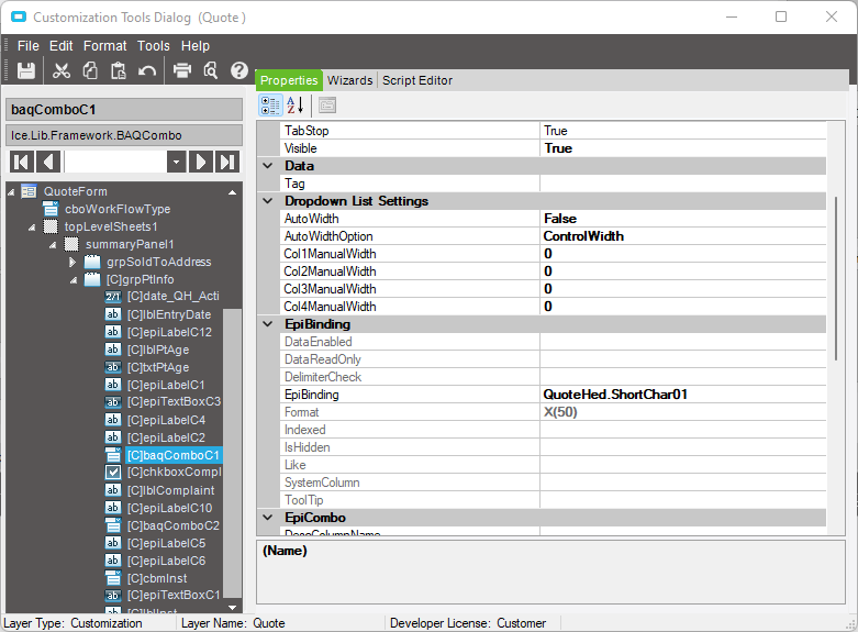

In your customization, add a BAQCombo and bind it via the EpiBinding to your new field on UD_Vendor.
In the BAQ Information properties, set your DisplayMember to the {table}.{field} value you want the user to see in the box. Set the DynamicQueryID to your BAQ name. Set the ValueMember to the {table}.{field} value you want the selection to store in your binding.

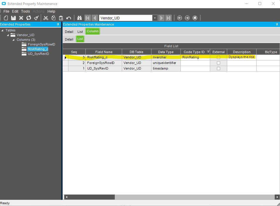

Made the User Defined Column Maintenance
Ran the Regenerate Data M.

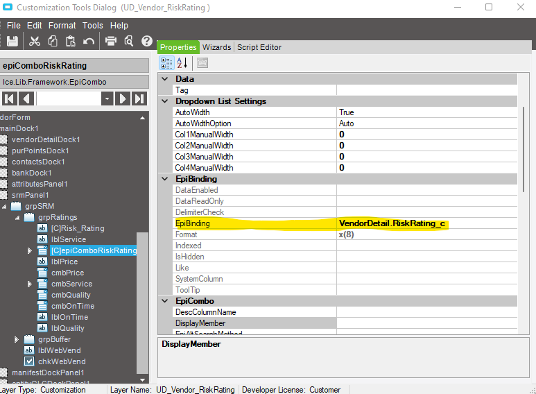

Launched Developer mode and made the Customization of the Base Layout.
Within the customization I added the EpiCombo Drop Down and pointed it to the UD Column I created.
Saved the Customization.

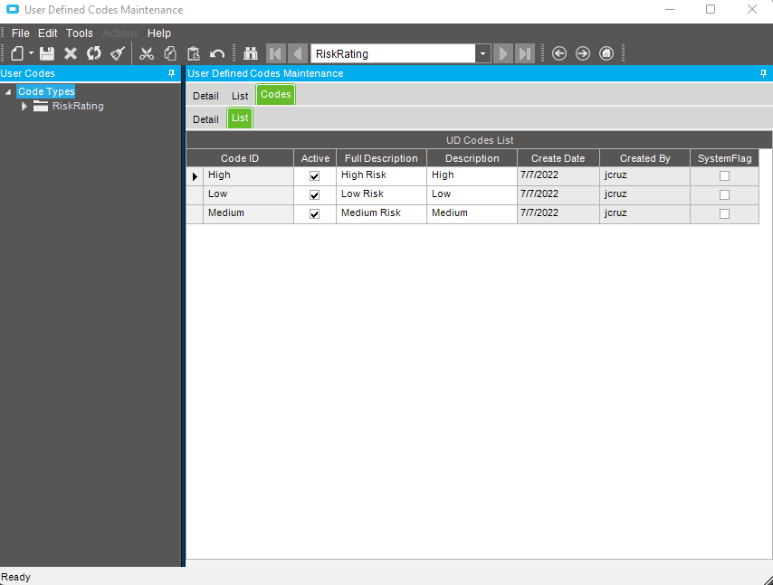

Created the UD Codes
Added the codes in the Extended Properties

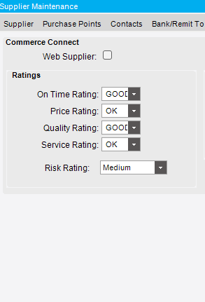

Restarted Epicor but had no luck. The Drop down is there but its grayed out. Any Suggestions?
@Aaron_Moreng I’m gonna go your route if I cant get this one to work.
Update I have no Idea why, but I rebooted Epicor again and launched the correct customization and now the UD Codes are appearing.
