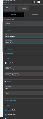

How can I create drop down list based on OrderHed.PayFlag.
and retrieve values based UD04 table in application studio
This is the default in application studio:

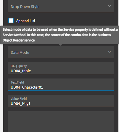

Create a BAQ with your UD04 as the table.
Then in your Combo Box use the retrieve BAQ features.
Yours would be UD04_Key1 = ‘{OrderHead.PayFlag}’
The EpBinding here is the field you want the data stored into when it’s retrieved from the BAQ…

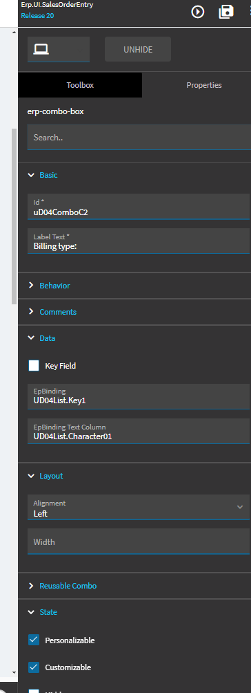

Thanks,I created this one but it doesnt work.

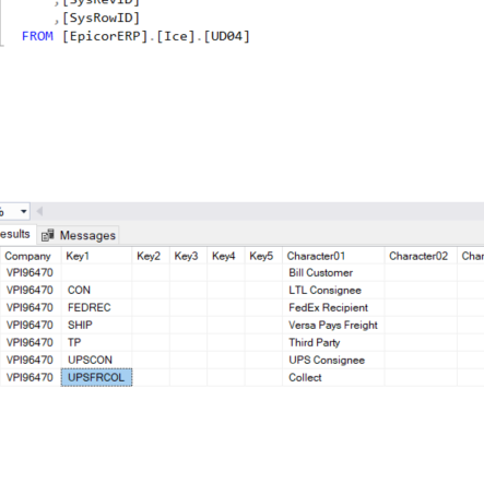

We have billing type in which is in OrderHead.PayFlag
now this retrieves values from UD04 table, Key1 is PayFlag and Character01 populates in BillingType.

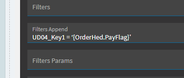

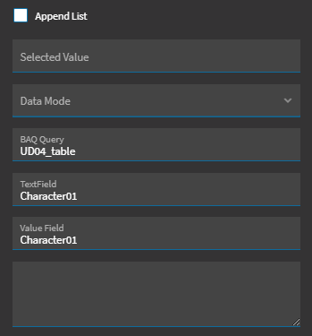

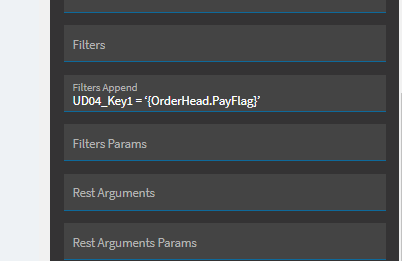

I haven’t reviewed the whole situation… but you may need to the table name included in the fields:
So it would be: UD04_Character01

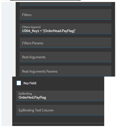

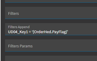

ALSO… in your other snip… you’re using “OrderHead” in your Filters Append:
Should be “OrderHed”… no “a”.

Thanks for looking into it. I have made the changes but it still doesn’t work.

The goal here is match OrderHed.Payflag with UD04_Key1 and retrieve UD04_Character01 in the dropdown list.

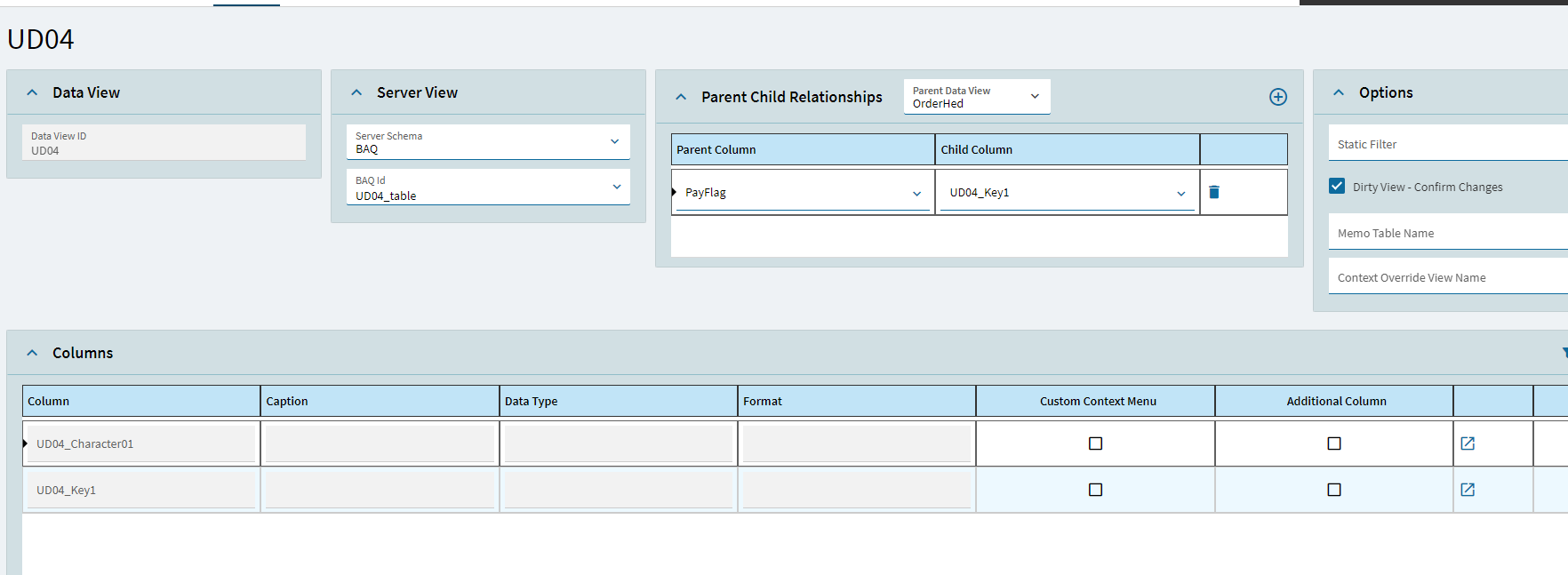

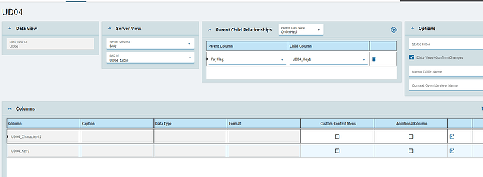

Do you have a BAQ DataView set up? This could make it easier. It looks like your very first image shows a DataView called UD04List. Is that correct?
Do you have an event to populate the UD04List Dataview?

Keep an eye on that Parent Child Relationship in your BAQ Dataview… I don’t think that is needed.

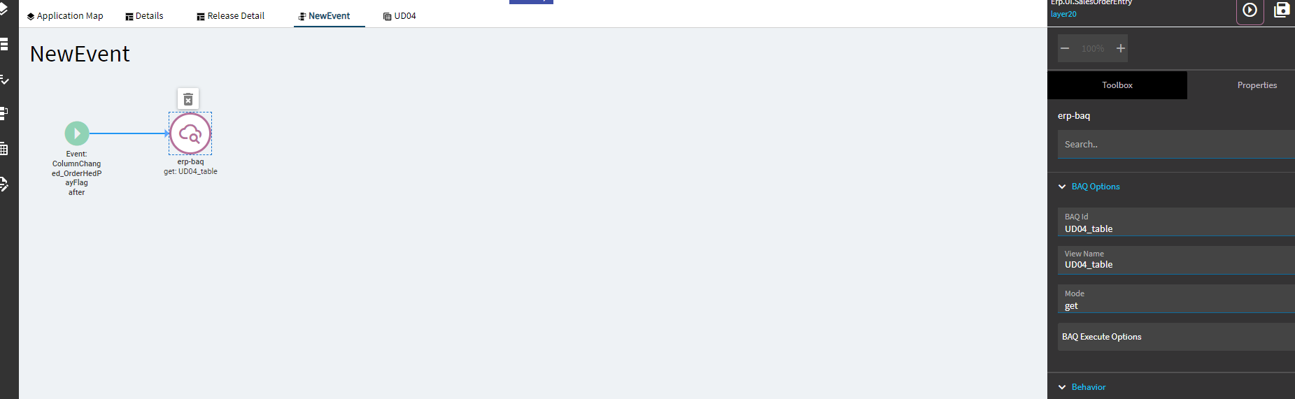

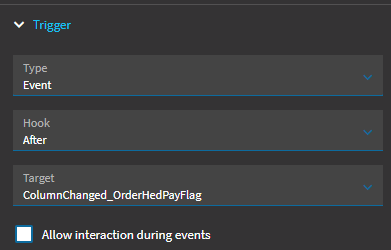

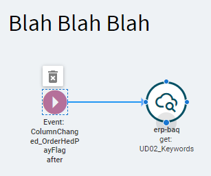

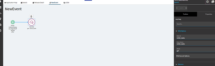

There is an existing event called “ColumnChanged_OrderHedPayFlag”… so I would create a new event “after” that one…

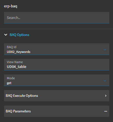

Use your UD04_table name here for your BAQ… I obviously don’t have that as an option.
Once you get that event set up, I would preview in a browser and use the Developer Tools to verify your dataview is getting populated with results.
With this set-up… you’ll have to change the PayFlag to trigger the event to occur.

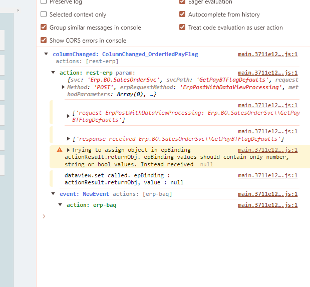

I just created that and previewed it and it still doesn’t work.
You erp-baq fired… which is good.

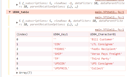

In your debugging… if you type in: epDebug.views
it should show you a list of all dataviews… you can then open up the UD04_table view and see if there is data there.

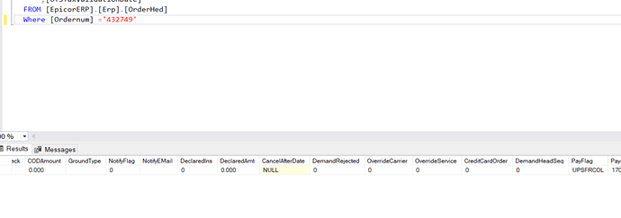

yes…its there.
Ideally it would be “Collect” as the Payflag is “UPSFRCOL”
Awesome… so we know the data is there. Now need to set-up the combobox to access it.

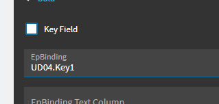

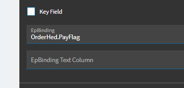

I think you would still bind it to UD04.Key1

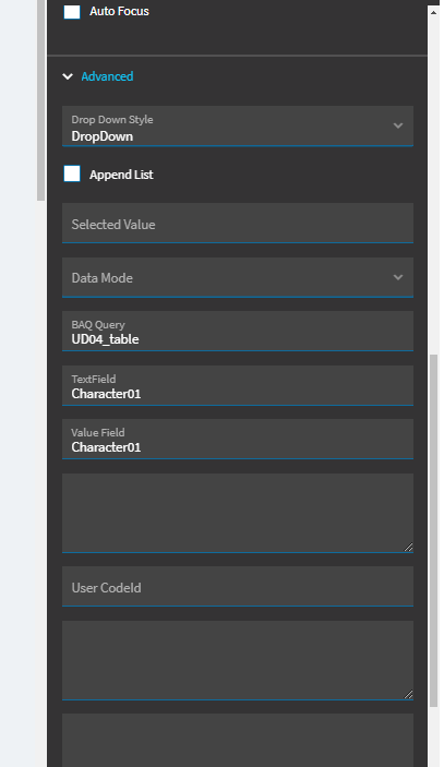

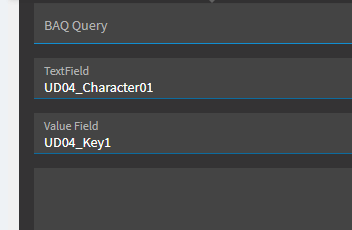

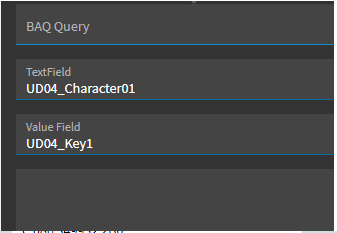

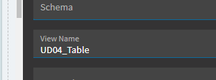

Under Reusable Combo… you can skip a lot of the earlier settings. I THINK all you need is to enter:
View Name: UD04_table (this is the dataview we want to find the data from)
Filters Append: UD04_Key1 = ‘{OrderHed.PayFlag}’ (this should hopefully filter the dataset by the PayFlag… assuming we can get the syntax right)
Under Advanced:
TextField: UD04_Character01 (this should be what’s displayed)
ValueField: UD04_Key1 (this should be the value we’re looking up in the UD04_table dataview)
Give that a shot.
Thank you so much. I tried it, and its greyed out now.

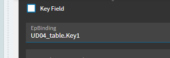

Change your EpBinding to UD04_table.Key1
Still greyed out.
Try removing the “UD04_” from these two. Since we’re already declaring the dataview as UD04… you may just need the column names.
