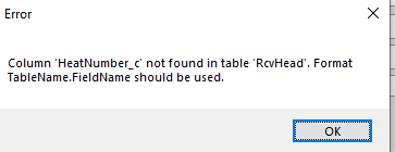

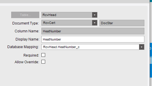

I went through the process of adding UD fields to the RcvHead table. This worked just fine, the fields are available to be added to Receipt Entry and I can see the UD fields in the BAQ. I would also like to tie these UD fields to metadata in my document type. I was able to tie one UD field just fine, it shows up when I go and attach a document and stores the values entered. When I go to add any of the other UD fields, it throws me an error. Even stranger I go to add the UD field that works to a different metadata field under a new name and says it can’t be found.
What am I missing here?
This One works
Error adding same field

This is a known issue. I would create a ticket with epicor so there are more requests for this to become a feature.
UD fields to not come in with MetaData just yet.

I just checked a test environment I set up with 2024.1.5 and…nope…
No _ud fields available in MetaData.

The problem is PRB0278463. Apparently it is fixed in 4.3.200
The latest release available as of right now is 4.2.100 (the version I have installed)
Is K2024.1 = 11.3.100?
Does the SDK follow? 4.3.100?
They show the ICE version with the fix of 4.3.200. I believe this would be the next release.
