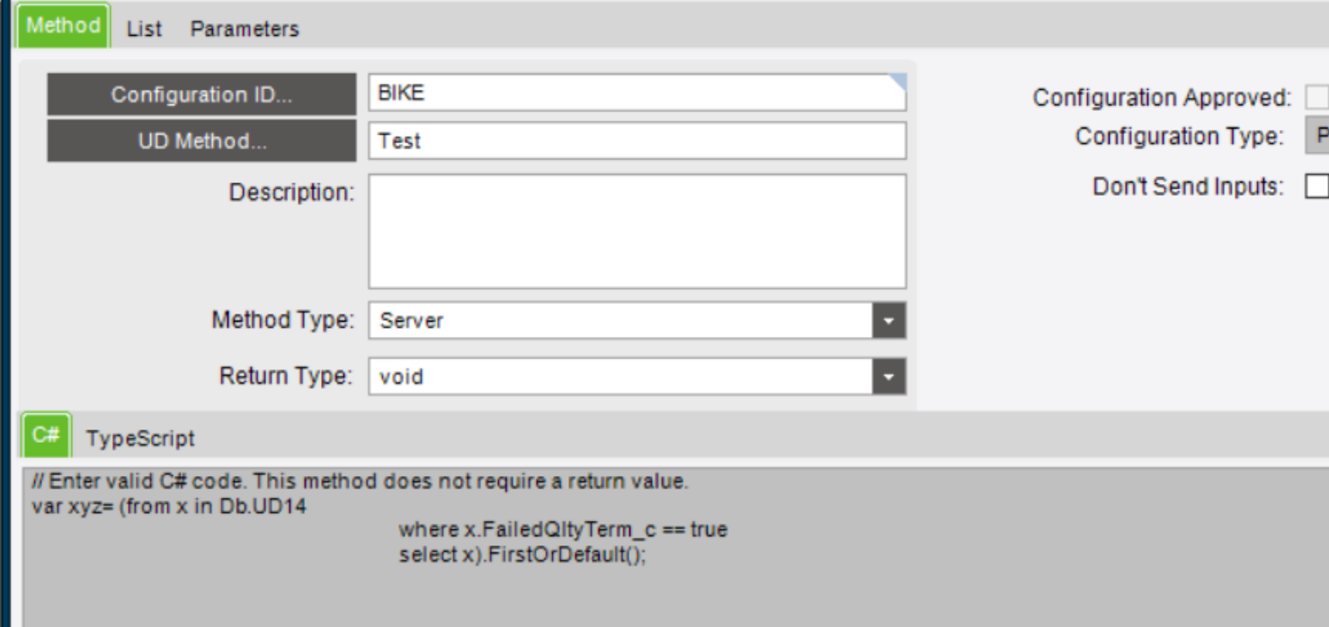

Can you post a screen shot of your method - like this shown below? This accesses UD14 and a UD column just fine (using same code). I was always under the impression _c was required on UD column names when creating but sounds like you may have an issue before that. Can you post the error as well?
