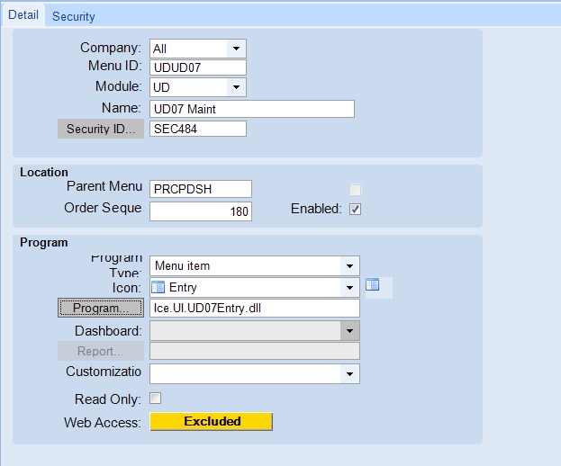

Brandon,
You can go to Menu Maintenance and add the UD07 Maintenance program to your Menu and maintain records there.

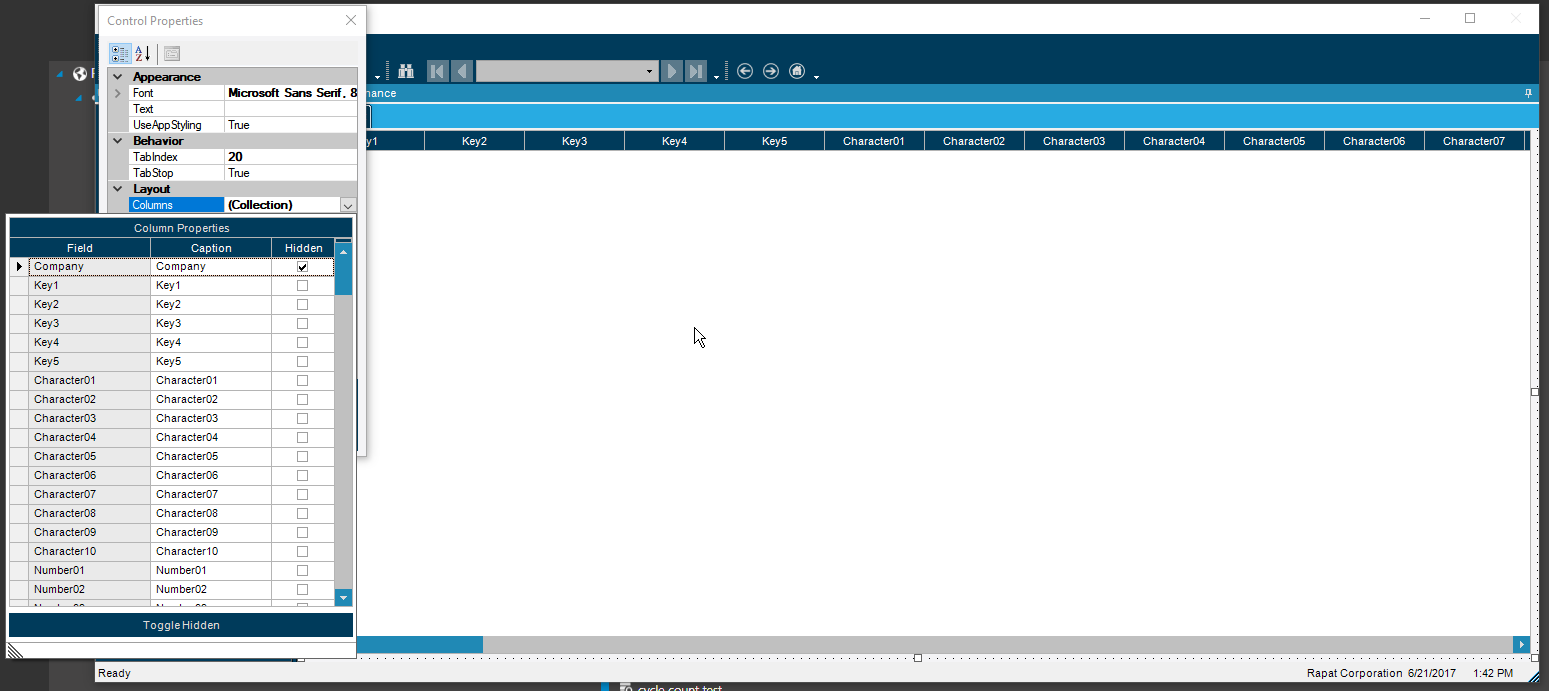

I figured it out. I need to have at least one of the built in fields (not the key fields) populated with something. like Character01. Once I add those in, the rows come back.
For stupid. At least I got it figured out. Thanks for the help guys.,
How do I add the extended fields?
Add to the Menu then Customize by adding/hiding fields.
But the extended fields don’t show up in the grid to unhide. How do I add those?
It was a data model sync issue. I synced the models, but without an IIS recycle, it didn’t show up. They show up now.
oh that might have been your issue all along then
yup. It was. And now the extended fields show up in the UD maintenance menu, so I’ll just use that, because at least I can delete from there.
