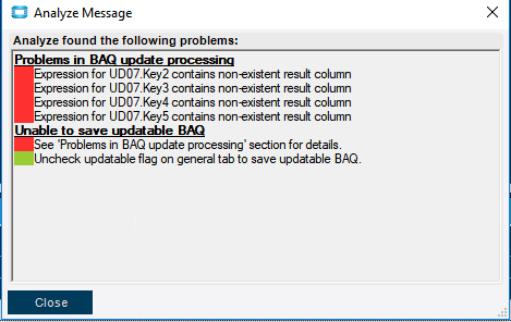

I made a BAQ for UD07. Added the fields that I needed to modify and added Key1. Saved the BAQ
Then I made it updateable, using the UdateExt BO for UD07.
Hit save, and I get this error.
So I added the rest of the key fields. Save with no errors.

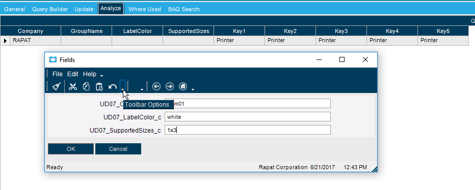

Now I go to add new line (the table is empty at this point.) A new line pops up I double click and get the input screen. I add my inputs, shows a dirty line, update, the line goes away.

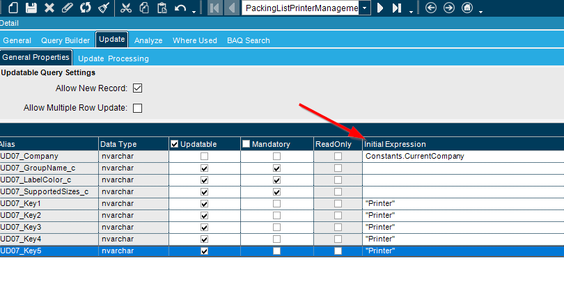

So if I go to populate Key1, I’m assuming that I do that in the initial expression right?

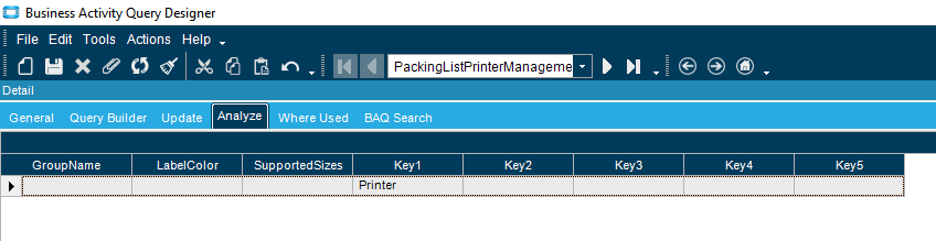

I add a row, then update.
This after update.

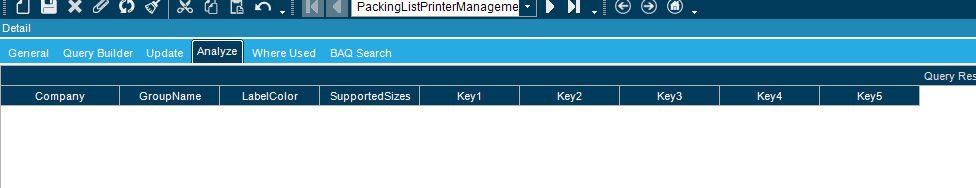

This after get list

You need all the keys for the udpatable baq to work Company, Keys1-5 and then your custom fields.

No joy,
all keys, company too
after update on the dirty row
Get list, empty again
Wait how can get list be empty? Are you adding a new record? If so the Key fields need ot be updatable too.

I still can’t add to the list after making the key fields updateable.
