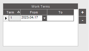

So this is the way people pick the dates:
Later I grab every row in the table by doing something like:
string dateFromStr = this.table.Rows[i].Cells["From"].Text;
Datetime dateFrom = DateTime.ParseExact(dateFromStr, "yyyy-MM-dd", CultureInfo.InvariantCulture);
So when dateFromStr is in the form of 01/01/2024, this will cause some problems.
Currently, I am checking if dateFromStr contains “/” and then converting it to a datetime that way.
Are you saying I can access the date value without having to grab the string? Alternatively, if there is a way to catch all date formats, I’m all ears!
