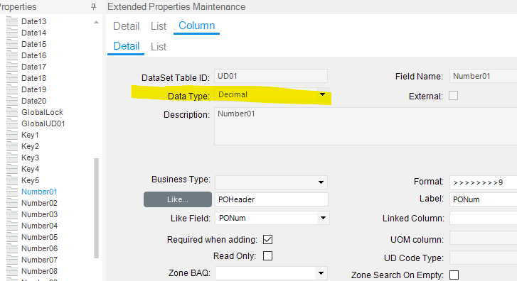

I am creating a custom UD menu with its own UD table. But i noticed that all 20 of the UD Number fields are set as Decimals and its causing BAQ relationship issues. Is there any way I can change an existing UD Number field to Int32? It will not allow me to change it from the Extended Property menu. Is this something i can request from Epicor to change?

Thanks… Meaningful names would be nice. But since we are in an Epicor SaaS environment, Epicor has already determined these UD tables and UD fields out of the box, and named them as such. Hence, my question. I was hoping not to have to create a new number field while i have 20 unused ones.

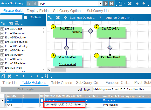

Have you tried to convert your numbers in the realtions?
