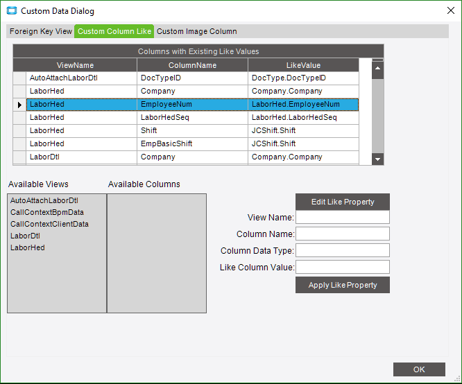

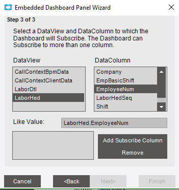

However, I ran into a few issues. The first being that EmpID or EmployeeNum column is not available in any of the Data Views by default in Office MES. So tried using Data Tools Custom Column Like to add LaborHed.EmployeeNum.
By doing this. EmployeeNum now shows up as a column to subscribe the dashboard sheet too.

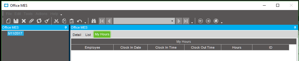

However, when I launch Office MES, with the dashboard, it does not subscribe to that column, and I get this error message.
Warning- Embedded Dashboard invoked as a Subscriber, but there is no Filter defined for the Published columns. Please notify the system administrator.

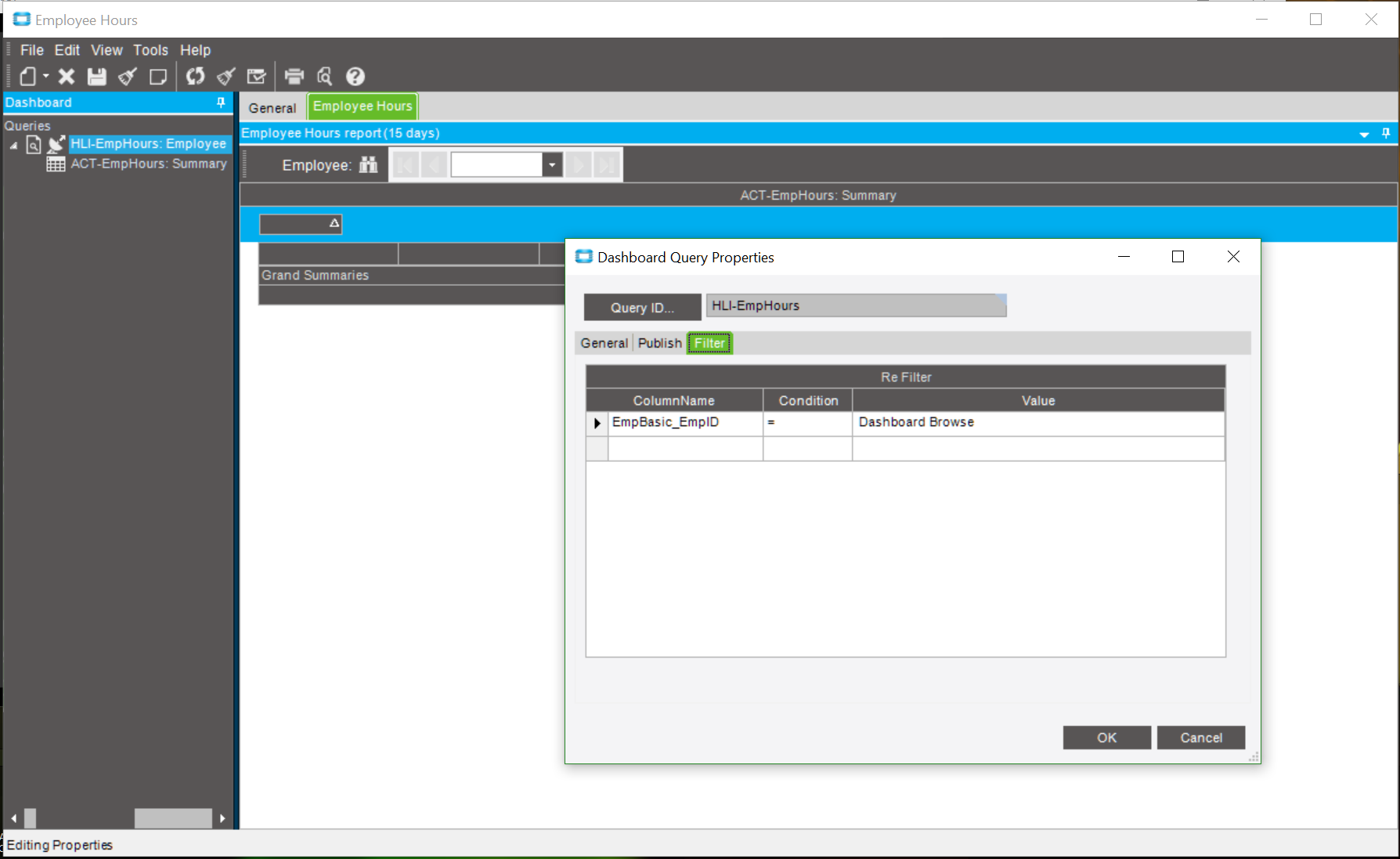

@Chris_Conn, the dashboard has the following filter on it.

My issue is the grid does not populate with any data. The grid shows columns from the BAQ, but no data.
I assumed if I I commented out all but the 1st two lines of the CreateHoursBAQView function (where is sets the view) I would get all the data that shows when testing the BAQ, but that still shows no data…

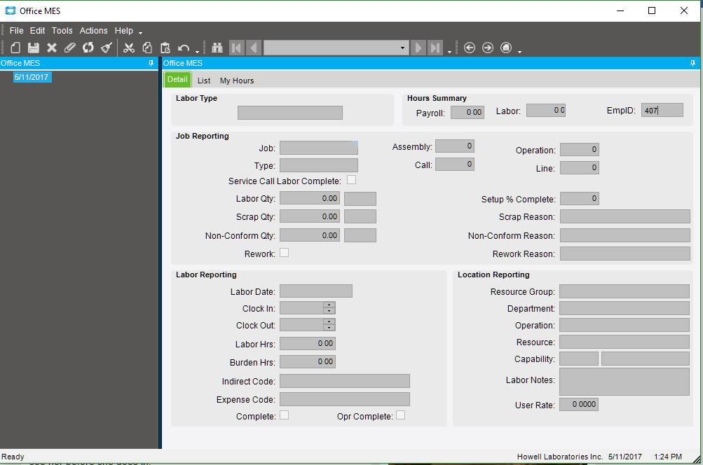

The EmpID field in top right-hand corner is bound to LaborHed.EmployeeNum and it’s populated, but the BAQ is empty.

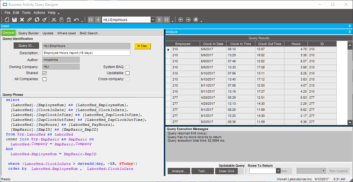

So when you run BAQ in designer you can see the EmployeeID?
Yes, both LaborHed_EmployeeNum and EmpBasic_EmpID, not that both are
needed. It’s showing all LaborHed records for the last 2 weeks and I want
to filter it by the Logged in EmpID.
