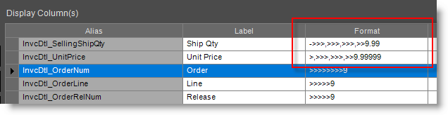

Look at the format column in your BAQ. Do you have a " - " at the beginning.
In the example below, InvcDtl_SellingShipQty would allow for a negative number while InvcDtl_UnitPrice would not.
That was it! Thank you!
Thank you! This worked perfectly

Unfortunately, it doesn’t just allow a negative, it requires it. So is it possible to allow either to be entered in the same field?
