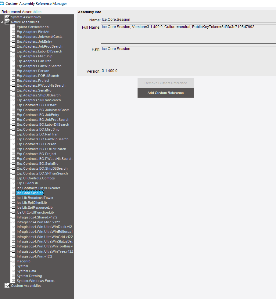

Welcome to the mysterious black-box world of Epicor coding …!
Not everything you’d think would be referenced is in fact referenced. You’ve got the right "using"s here, but you may need to go to Assembly Reference Manager (from the “Tools” menu) to actually make sure they’re in place to be used.
usually it is exist by default under the native assembly of all UI, what screen are you using ?

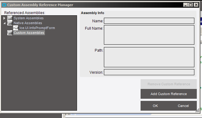

I’m customizing a BPM data entry form (UI.InfoPrompt.IP_QuoteEntryLine). When I open Custom Assembly Reference Manager here’s what I see under Native Assemblies:
Basically I only see Ice.UI.InfoPromptForm.
Click “Add Custom Reference” and add Ice.Core.Session.dll. I think it should default you to the correct folder, thought you may have to remove the file type filter.
I normally add the Ice.Core.Session.dll in the Custom Reference, but there are instances where I added and it still says missing reference and then I have noticed that for some reason the dll added the namespace is lower case instead.
So I exported the Customisation and change the case in the XML file then reimport again.
I found Ice.Core.Session.dll, it was me not noticing the filter on the extensions! Details, details… Thanks for all your quick help!
