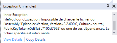

I am trying to create an Epicor session in my .Net application and I keep getting errors. I found this way to establish connection in this forum:
Session EpiSession = new Session("scanner", "scanner", Session.LicenseType.Default, @"C:\Prog\Epicor102600\Client\config\Test-Dev.sysconfig");
// do whatever
I keep getting error about Ice.Epicor.Version or one of it's dependency unable to find file...
The references I added are as follows:
Here is the error:
What Am I missing ?
Pierre

Pierre,
Can you launch Epicor from that workstation using that config file?
Yes!
I have removed the references, and add them back from C:\Prog\Epicor102600\Client
Now I got a different error about communication…

Is it a .Net Framework App or .Net Core? I don’t think a .Net Core apps can talk directly to Epicor dlls…
The references look right. Are you referencing those files from the full client install folder so they can find their dependencies?
You may also want to consider talking to Epicor via the Rest API.
Brett
.Net framework.
I redid the references pointing from the client folder and got the latest error message.

Any error in the event viewer on the server?
Could not distinguish any…
But redid all the references again… and it worked!
