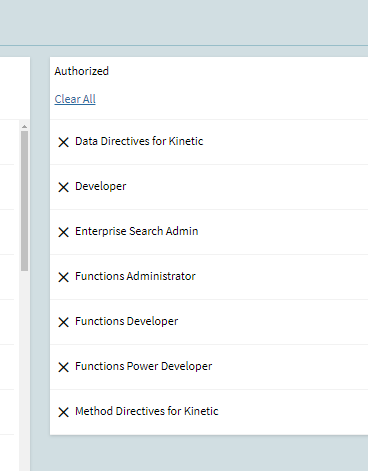

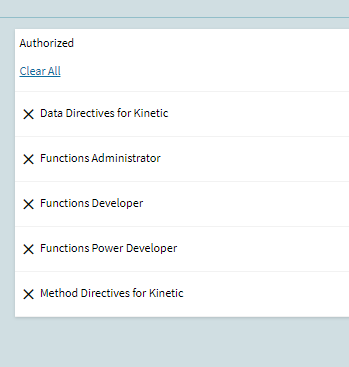

@aosemwengie1 do you have ALL the Function groups?
Yes I have every group.

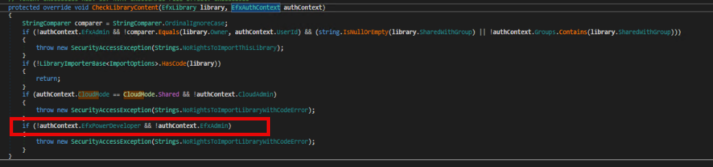

Are you in a Shared cloud @aosemwengie1 ? I found some code that says if you are in a shared cloud environment they prevent this.

Can you remove yourself from these two groups and add yourself back in (then log out / log back in)

So looks like you don’t have Functions power developer rights. You need that to create / install custom code functions (that has always been the case)
But maybe they changed your permissions in this upgrade?
