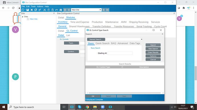

Hi,
We are unable to set the GL control account at the Site Configuration Level.
Upon clicking Create GL Account, no GL Control Type is available for selection.
(we have created GL control Codes)
If we try to use existing GL Control, we get an error Invalid Control Type.
Due to this we are unable to Capture COS/WIP and the error generates, Error: Header Rule : Can not set up Journal Code
Please assist.

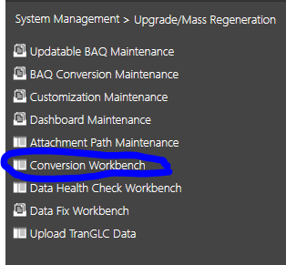

Try running the below conversion from conversion workbench. Once this conversion completes, it will import all GL transaction types.
cvpe0000 - Import GL Transaction Types

@varanimesh
Open the below menu and find the “cvpe0000 - Import GL Transaction Types”
Select the row and double click
Action menu -> submit

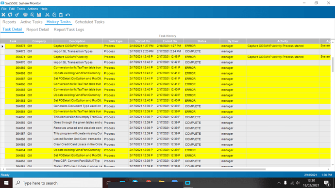

Hi @prash172
We ran the conversion process via the conversion workbench, we imported the GL transaction types,
But we still can not get the GL Control Types selection options at the site configuration level.
Please assist.

Could you send me the screen shot of the error .
Hi @prash172, here are the screenshots

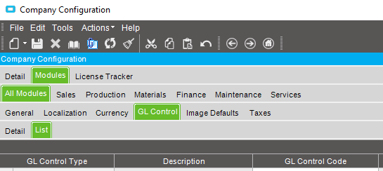

Check whether GL control code is defined ?
Menu Path:- Finance Management -> General Ledger -> Setup -> GL Control Code
If the above setup is complete, then go to company configuration. Assign the inventory GL control code.

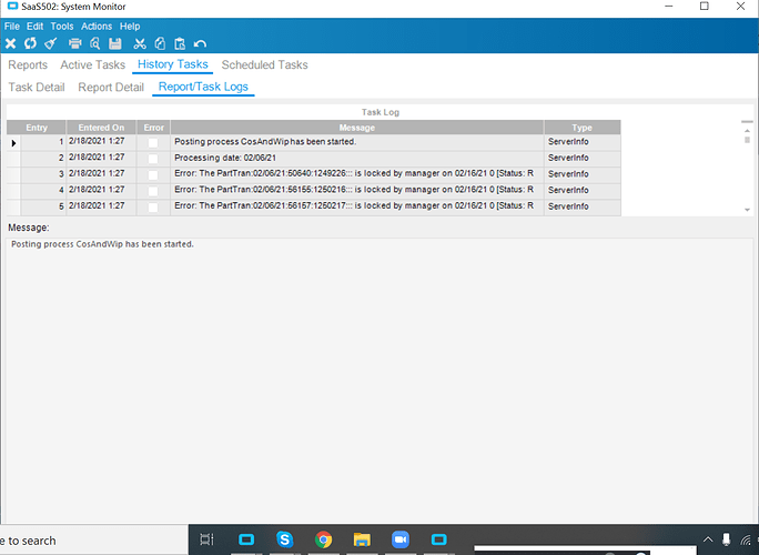

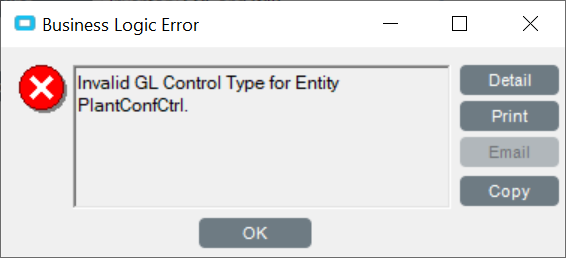

Hello @prash172, we have set the GL control codes for Inventory COS and WIP, also set it at the GL Control Code level,
But we still get an error. Please assist.
Screenshots attached.

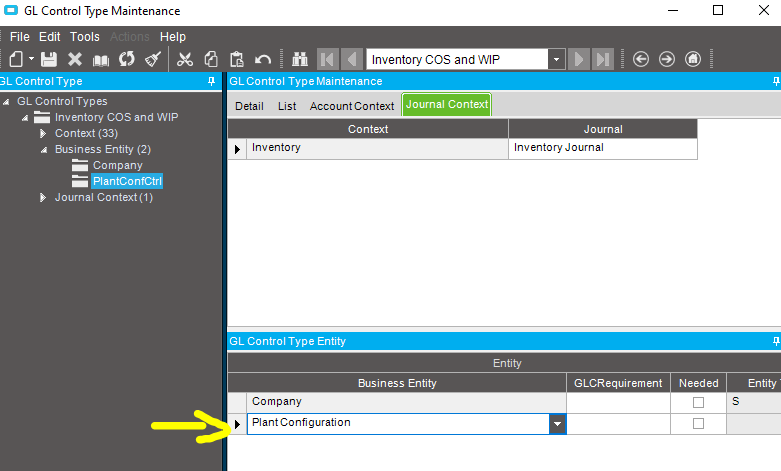

@varanimesh
Finance management -> General ledger -> Setup -> GL Control Type
Select inventory cos and wip and add Plant configuration as the value to the business entity.
This will enable the gl control type in the plant configuration under inventory.

Have you set the default GL Control Codes at the Company level?

@jkane Yes we have

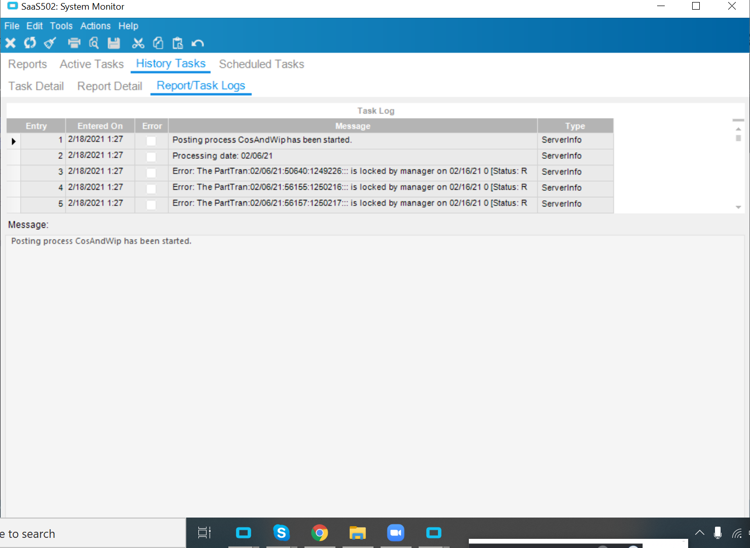

OK, so the error is “can not set up Journal Code.” I don’t see what led you to thinking that the problem is this Plant Configuration GL Code. I feel like these are unrelated.
Can you elaborate on those other error messages that say, “locked by manager… Reviewing in 11 R…”

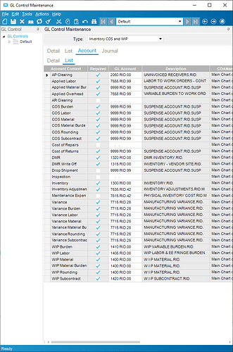

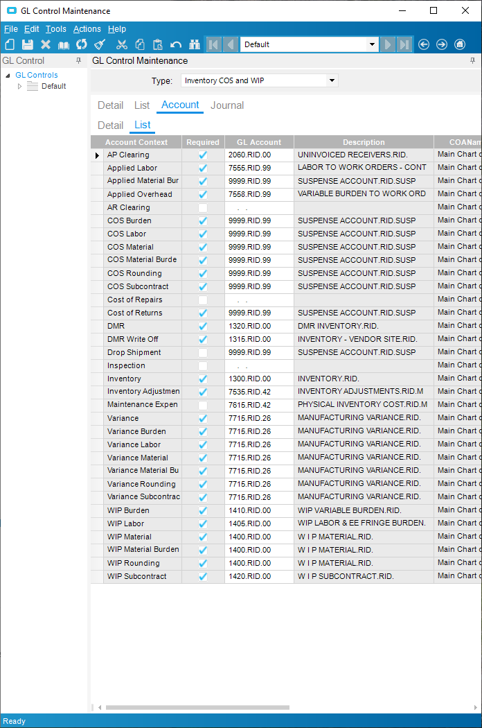

But to cut to the chase, in your da01 GL code setup (the company COS/WIP one), I implore you to have an account number filled in for every required “context.”
Maybe you are thinking, but I don’t want it to use the company setting! Well, sure, I get that.
What we do is use “suspense” (9999) as a placeholder in those cases (see pic below). This way when we run the Inventory WIP Reconciliation Report, anything that hits suspense (9999) is a big red flag and MUST be fixed before capturing the transactions.
This brings up a question: are you using the Inventory WIP Reconciliation Report? It’s a must.
