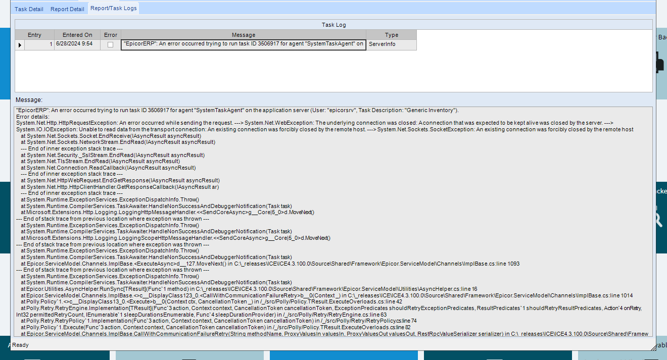

reinstalling the task agent now.
any other details other than rendering report?
