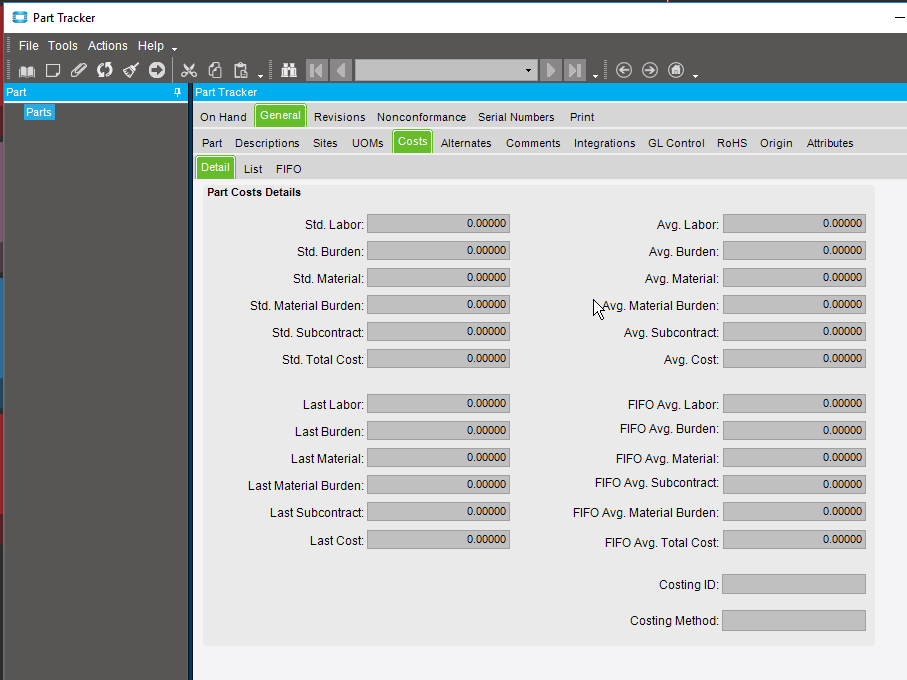

If you go to part tracker (not entry), then general tab, then costs. It should be in there. Depending on if the part is set up to use standard or average cost it will grab from one of those fields I believe. (anyone feel free to correct me if I’m wrong)

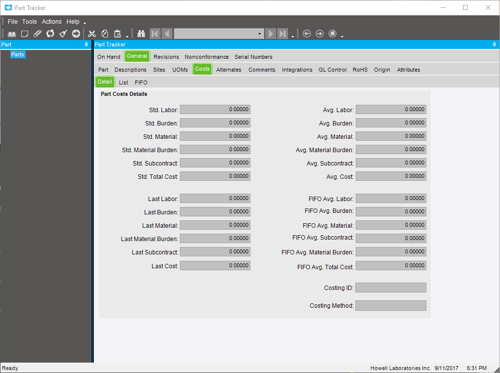

Just a wild guess, but doesn’t it depend on our costing method? Did you
check Part Tracker | General Tab | Costs, to see if it lines up with any of
those?
