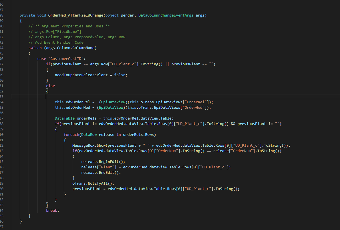

Hi Guys,
I’m new to Epicor and still trying to get hold of the beast. I have a problem in customization. I’m trying to update the plant and the warehouse of the releases on a certain condition in orderhed. The issue I’m facing is that the fields are changing in the UI, but I cannot save afterward since it’s telling me that the row has been modified by another user. Here’s the code :

Thanks for your answer. I think I found my problem but not sure how to fix it. The problem is that the trigger that is modifying the Order Releases is on customer change. I then modify the releases but when I finally save, Epicor tries to update the release as well to change the customer on the release. Since the row is already modified, it throws an error saying that the row has already been modified. I have no clue how to fix that though.
