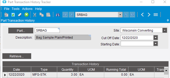

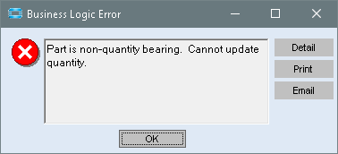

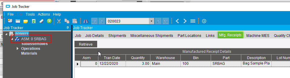

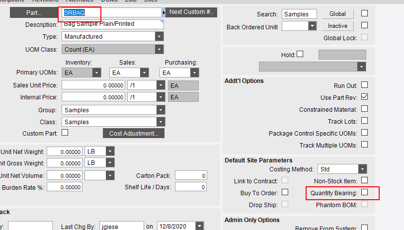

You can receive to inventory when the part is not qty bearing?
edit
I can’t even do a Qty Adjust on a non-QB part.
I meant to say non-stock not non-qty bearing you got me all confused with your nonsense lol. But surprisingly yes you can receive it.

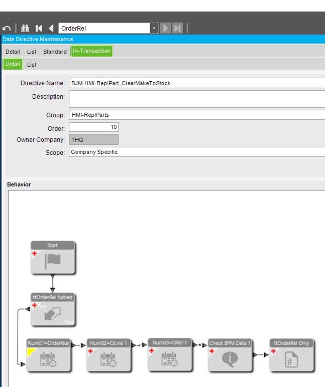

Send a screenshot of your BPM diagram and a copy of the code you are using.
If it’s the default first release of a line – I am using the data directive but where it is available is my issue. The criteria is ProdCode != “1WG” AND ProdCode Starts with “1”. I have all this done. I move the OrderNum, LineNum and RelNum to callcontext. All which I validate with a popup. BUT
