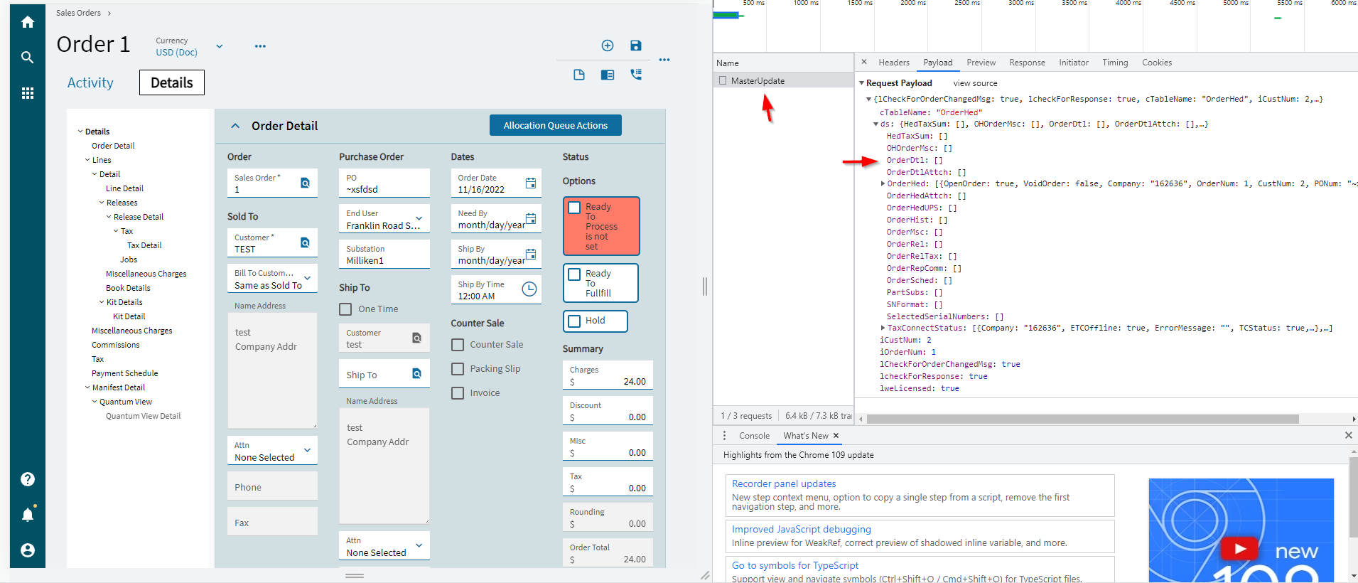

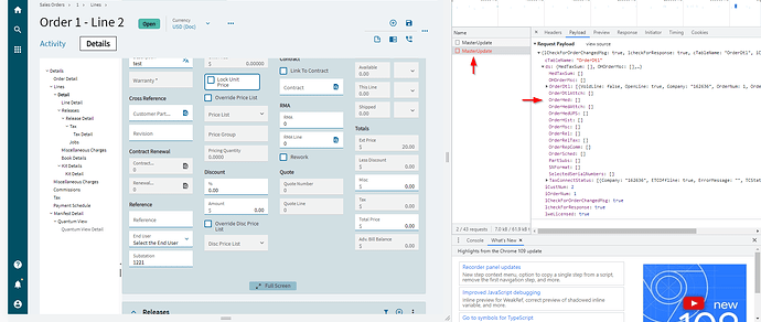

I have tried using MasterUpdate as well. The problem is that when I change the UD field in OrderHed, the payload for the save only populates the ds.OrderHed and ds.TaxConnectStatus (which I don’t need). The ds.OrderDtl tableset is empty. If I am saving a change at the Line level, only ds.OrderDtl and ds.TaxConnectStatus is populated. Somehow, I need to get ds.OrderHed and all of the ds.OrderDtl record populated so that I can read the values from the header and compare to the line values to see which lines need to be set.

I did mine in classic, let me see what happens in the browser.
BRB
They’ve made a breaking change from Classic To Kinetic.
In classic, that data is always sent, in Kinetic, they aren’t passing it if it doesn’t change.
Your best bet is to pull the detail in code or widgets, and fill the dataset for OrderDtl.
