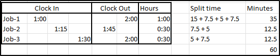

Thanks. I’ll try it and see. My main reservation was that I just don’t know what that calculation is nor how to check. I am aware that it takes into account multiple concurrent labor details (not sure if there is any way to weigh the splitting or if it’s just an even split) and it also takes into account break times. Knowing just that, I can hazard a guess.
The split looks something like this.
Job-1 Clock in 1:00
From 1:00 - 1:15 Full allocation 15 minutes
From 1:15 - 1:30 Split between 2 jobs 7.5 minutes
From 1:30 -1:45 Split between 3 jobs 5 min
From 1:45 - 2:00 Split between 2 jobs 7.5 minutes
35 min total allocated to job-1
