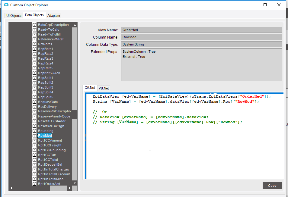

You have to get a hold of your dataview. Basically it’s the TT table that you see when you are doing your BPM. In a customization, it’s a data object. Use the Data Object explorer to find it. Then you will have to set the property in your customization.
Thanks. I found the screen that you reference via the Customization screen -> Tools -> Object Explorer -> Data Objects. My screen looks the same as yours.
What am I trying to do with this screen? All I’m trying to do is have a user click a checkbox, click save, then have a BPM run. Do I need to write some sort of custom C# code in this object explorer to make that happen?
Confused.
That gives you the data that you need to be able to change the rowmod to “U” so the BPM sees the row as changed.

if you dont want to make a UD field. You can probably do AfterFieldChange against CallContext dataview
afterfieldchange  (pseudo code)
case "CheckBox01":
var edv = oTrans.Factory("MyEdvForRecordTypeOfBO");  //i.e. JobHead, etc  - it must exist- see obj explorer
if(edv != null)
  if(edv.Row >= 0)
    edv.dataView[edv.Row]["RowMod"] = "U";
break;

Jose… I’d like to try doing this. Do you have an example around on how I can set the RowMod on Order when my checkbox is clicked?
I’m guessing this is some C# code that I add into the Object Explorer like the screen shot in this thread?
Thanks.
@Chris_Conn’s post is the code that you will need to do that.
