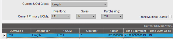

We stock aluminum extrusion in “Lengths” and consume it in inches, and the conversion is handled in Part UOM Conversion Maintenance; is it possibly similar?

If they are always ordering by the number of inches, then you’d create an “Inch” Part-Specific UOM on the Weight UOM Class, and the be able to specify that on the sales order as a Selling UOM. Each inch of PartX weighs 0.2225 pounds. They order 7 inches, Epicor does the math. They order 9.4", Epicor does the math. Quantity in the Sales Order Detail form is the number of inches they purchase.
