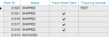

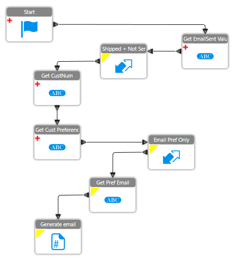

I am trying to use a UD column of type boolean to track whether or not I’ve sent a shipment notification for each PackNum. I send the notification using a Standard Data Directive and I’m trying to update this field after the email is sent. Everytime I try to fire an Update or UpdateMaster through the BO, I somehow end up deleting the existing PackNum and creating a new one whose UD column is set to true. Is there a trick to messing with the ShipHead table?

Regarding trying to update the Tracking Number. First, I tried to set the Tracking Number using my existing code (instead of the UD field). I got the same result. Deleted existing row and created new one.
However, I am using a standard data directive. I do not get a widget to set fields in that tool - so I am trying to do it by using the BO in custom code. Perhaps it’s too late at this stage to change it?
So I changed to an in-transaction data directive and just used the widget to set the field, it had no problem. However, I can see that field remains read/write in the UI. So I also tried to change one that I know goes to read only… that also let me change it with no problem.
Could it be because I am using a standard data directive?

OK talking this out, then, going back to the original intent…
Is there a better way (or is this still possible but I am goofing something up) to set the UD field I’ve created “TrackingEmailSent_c” to true when the email is sent? If I understand, I want to send the email as a std DD. But that doesn’t seem to lend itself to setting a field in the table we just reacted to.

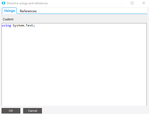

How do I get the String Builder to work? I tried using System.Text like the tutorial suggested. That isn’t working, though.
Unless you have a really good reason to keep it as a Standard, change your directive that sends the email to an in-transaction, and add in a step that updates the UD field at the same time.
A Method Direct (often called BPM’s here) might be the better place.

I was trying to add the using statement at the top of my code block. I learned today that is not where it goes in a DD! It goes in the Usings and References popup window. Just in case anyone else missed this obvious little caveat.
BTW, that String Builder seems to have sped up the email generation considerably. It used to be close to 5 seconds before I’d hear my phone buzz… now it’s like 1-2 seconds. So I would recommend it to anyone who isn’t aware of it.
