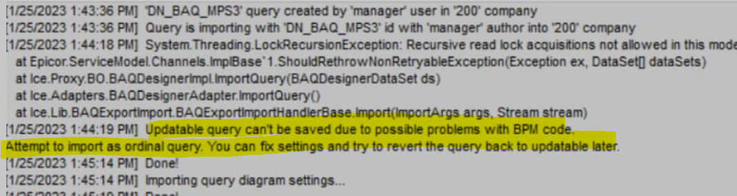

I’ve confirmed that there is nothing wrong with my uBAQ, this problem is more applied for any AutoUpdate.
I’ve successfully recreated this very uBAQ in Test. Got it to worked. Then I attempted to export it to Live and got this error message:

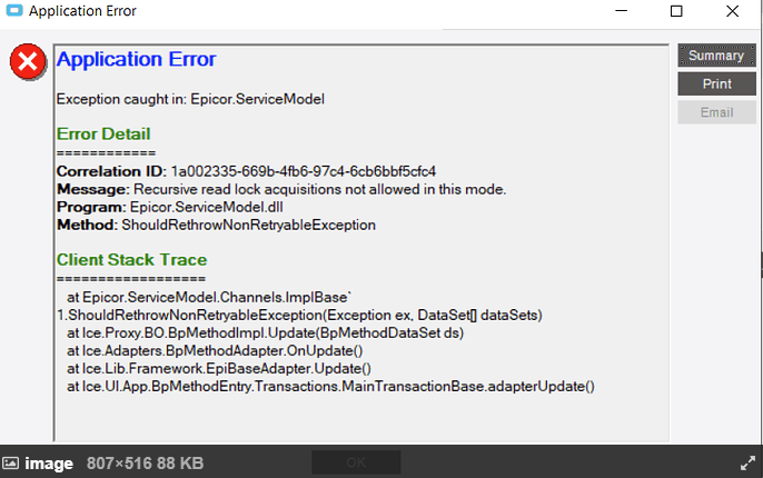

Since the error message is pointing to BPM. I tried disable any of the current BPM that we have for Part or JobHead table. And voila, this very first message appear when I try to disable, save, and re-able the working BPM.
Since the error message is pointing to BPM. I successfully disabled one of the current working BPM. After that, I tried to re-enable it again and this very same message reappeared.
