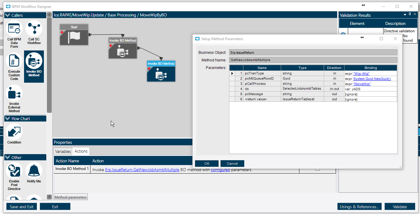

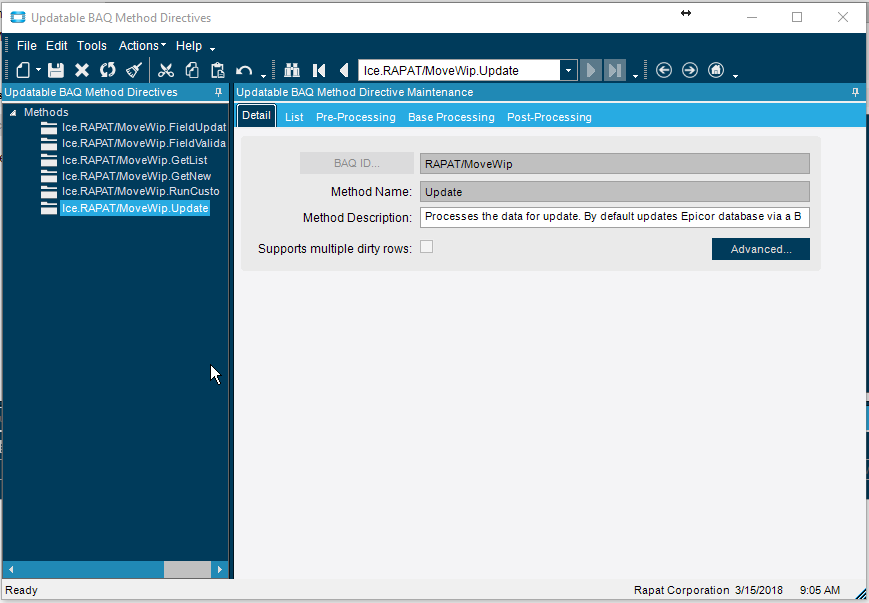

@Banderson you can use a UBAQ. Just click that “Advanced BPM” option instead of the standard BO stuff and you can write the C# (on the BAQ) to do the update.
ok, Newb question here. Which method do I put the coding on, and is it pre or post-processing? (or does this end up being one of those scary Base processing ones?!?!?!?)
And, finally, I’m assuming the code in the UBaq or the Customization can accomplish the same thing, is one better than the other for any reason? Ultimately, this will end up in a dashboard with a customization on it because I will need cheat buttons and validation and whatnot. Is it easier to just do all of it in one place? or is it better to do as much as I can in the BAQ and then only what I need in the final customization? Am I starting a religious debate here?
Update. =-> base Processing.

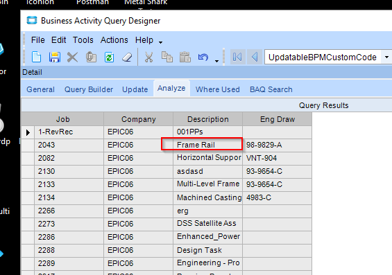

Here is an example. Simple BAQ Updates the PartDescription field on JobHead using the BO
UpdatableBPMCustomCode.baq (27.3 KB)
