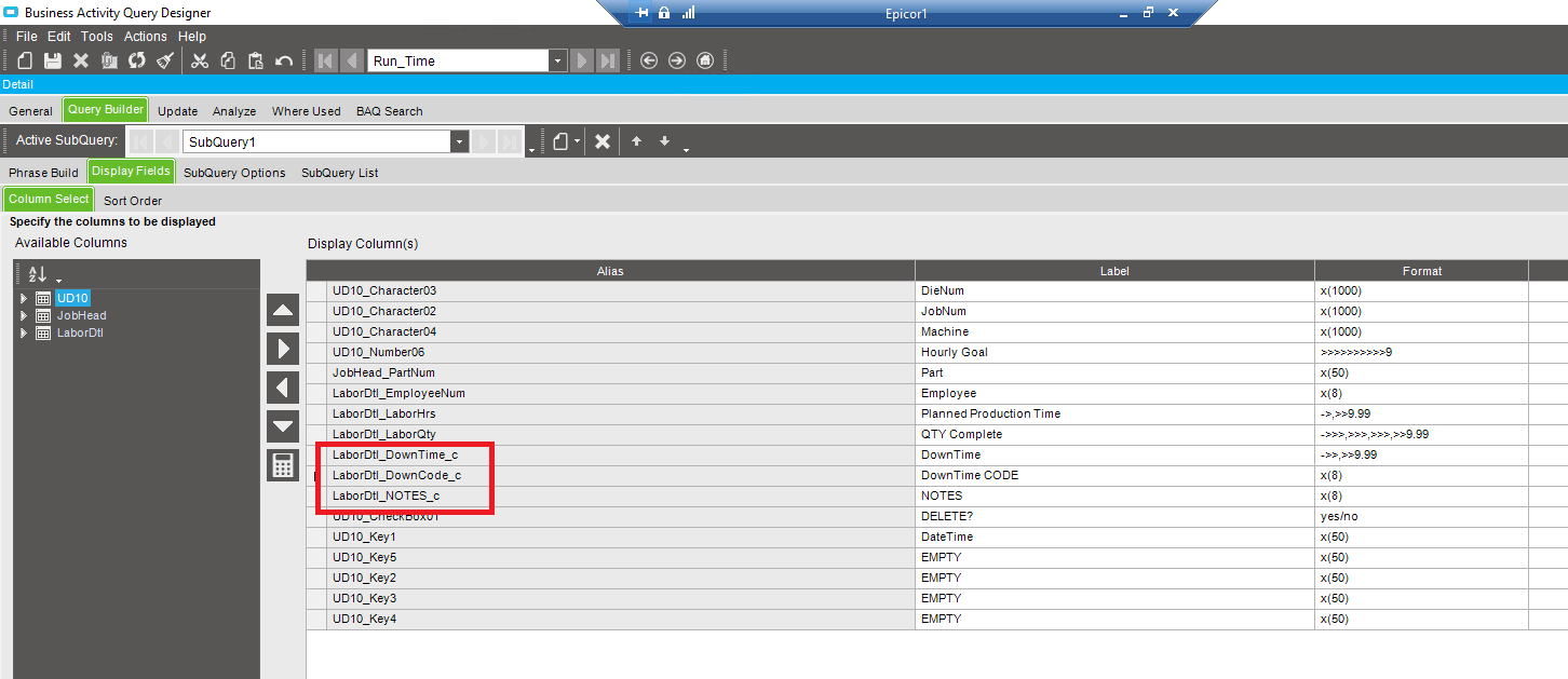

I have an Updateable BAQ that includes UD10, JobHead and LaborDtl:

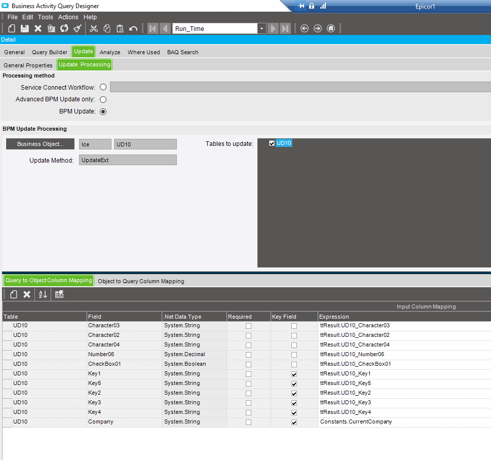

There are several fields in UD10 that update fine. But I also want to be able to update a few UD fields on the LaborDtl table:
I believe that I may need “Advanced BPM Update” to update both, since it is outside of the scope of the UD10 business object. But I have no idea how to accomplish:

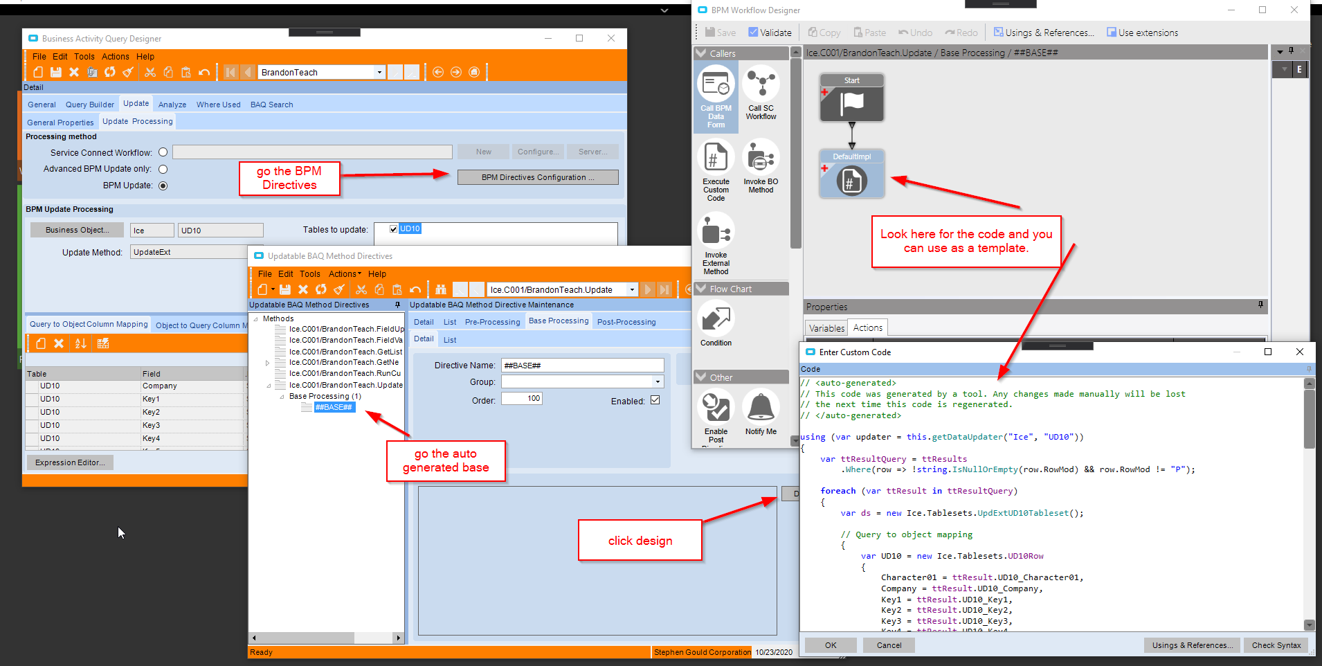

To piggy back along what @JasonMcD is saying, if you use the UD10 business object, then go into the BO and go the BPM directives and look at the auto generated Base method, you can see how they are doing the single BO. Then you can go do it for the other one, and take both of the code blocks and combine them so that you can do both with your own base method by using Advanced BOM Update Only.
