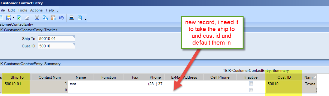

I’ve gotten close, but am going in circles and thought maybe someone will have an idea for me. I added a tracker view, for user to search and input ship to and customer id data. Then refresh is clicked and any existing contacts for that ship to / cust id are brought up. Now, when user does new record in the dashboard, I need the ship to and the cust id to default to the data in the tracker view. Nothing I have done so far seems to work.
I went to the updateable BAQ to try and mess with the BPM directives on that (screentshot 2), to no avail. The data is stored in V_TEIK_CustomerContactEntry_1View.Customer_CustID and V_TEIK_CustomerContactEntry_1View.CustCnt_ShipToNum

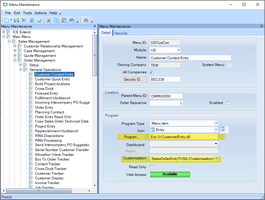

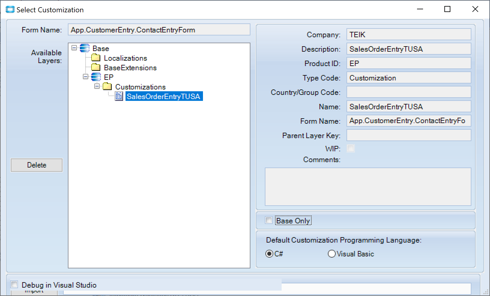

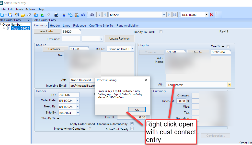

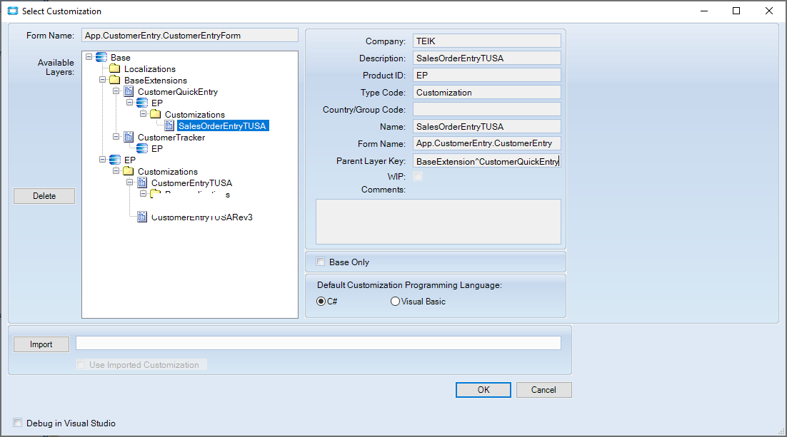

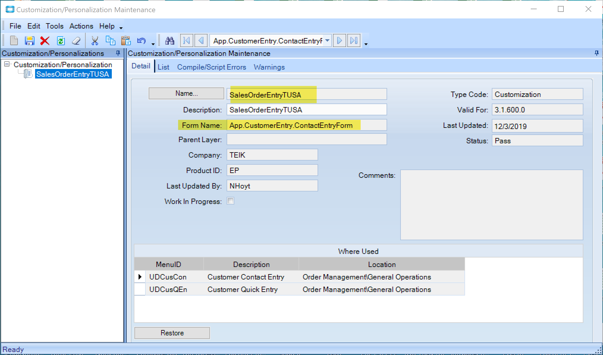

I am having difficulty recalling details of how/why I did what I did, but it’s working and perhaps can be helpful to a degree. There’s something about making a customization of another program have the same name as the calling customization where Epicor is tying hands on calling the program. Here in customization entry, where I have a customization on the Customer Contact Entry program to strip out unwanted tabs/actions/and fields, and call it the same as my customization on sales order entry, e.g. SalesOrderEntryTUSA. I think it also has to be deployed to the main menu per second screenshot. Then when it is opened via open with from Sales order Entry ship to attention field, it opens the customer contact entry.
I’m sorry for my confusion, it’s been awhile. I know I learned about naming the customization the same as the calling one from a post on here, perhaps someone who recalls better can provide more info.
HTH! Nancy

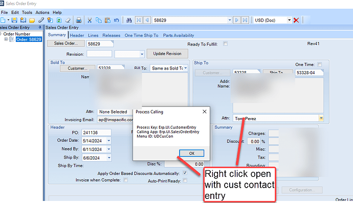

I’ve reviewed my context menu changes and couldn’t find anything there. I have however found that I put something in Process Calling that very well might be the key. See below. If you look at my screenshot two above, it shows menu maint and the UDCusCon deploment. This UDCusCon in main menu is setup with the OMMN3000 security for us, which is the same as Sales Order Entry security.
Hopefully this gets you there. Sorry for my fuzzy memory.
Nancy
Ah YES! I think that did it!
I am signed in as my order entry user, and it launches the slightly custom version of the Contact Entry form. Thank you so very much!
I found it interesting that we had never setup anything in Process Calling before. Also interesting, in the Application Help for Process Calling, it specifically mentions the “naming hack” in a note there, so that is exactly where that “trick” comes from too. Interesting to me, and probably to others, that it was actually documented.

So for ours we used process calling id for contact entry with customization name the same exact name as the contact entry. This allowed open with to open a different “reduced privilege” version of customer entry for contact entry per below screenshot. The reduce privilege allowed just entry of contacts and no customer entry. The menus and fields got suppressed for general customer entry for those without those privs and only allowed them to use the contact fields. See screenshots above too.
