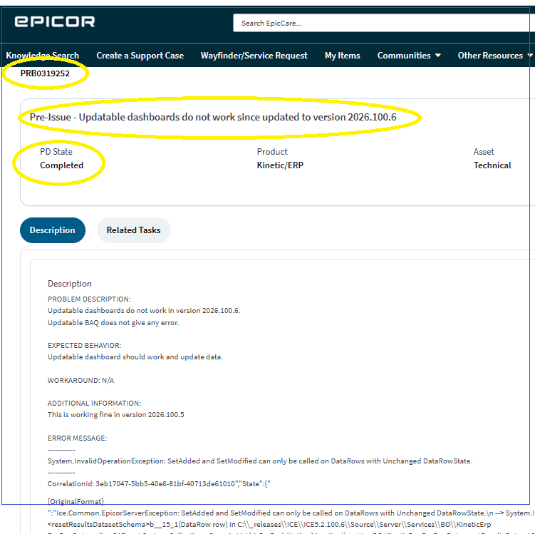

There is now an open PRB0319252 for UBAQ dashboards not working in 2026.100.6. We are on-cadence 2026.100.5 and that is the version we have been testing. There is an upgrade to 2026.100.7 scheduled for 2 days before Production Live. There are planned fixes in 2026.100.7 inc Quote worksheet calc, but new things such as broken UBAQ dashboards leaves us with only 2 days to test before Production. In testing - hopefully fixed before Production live.

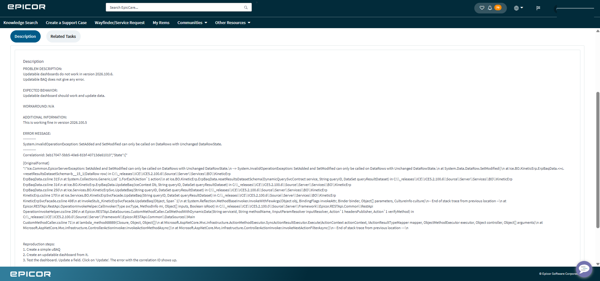

PRB0319252 PD State In TestingReproduction steps:
  1. Create a simple uBAQ
  2. Create an updatable dashboard. Use the uBAQ as the datasource.
  3. Test the dashboard. Update a field. Click on ā€˜Update’. The error with the correlation ID shows up.
We were seeing the issue in .5 though so… :man_shrugging: Our case is tied to that PRB too.
EpicCare has PRB0319252 regarding UBAQs now marked as completed.
